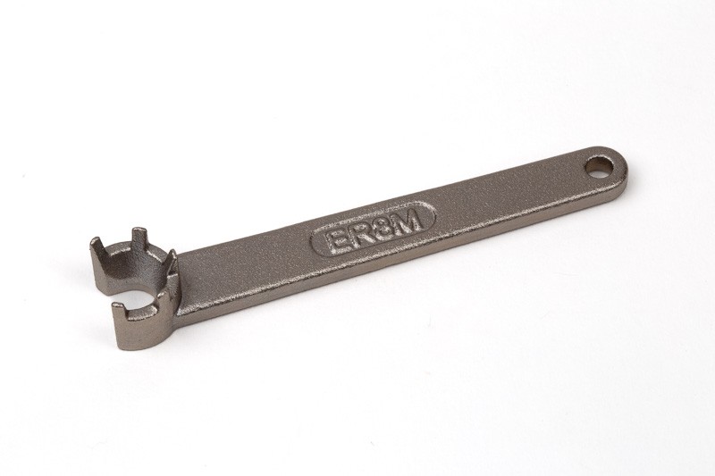

ER8M Spanner Wrench
Part #: 06-0165

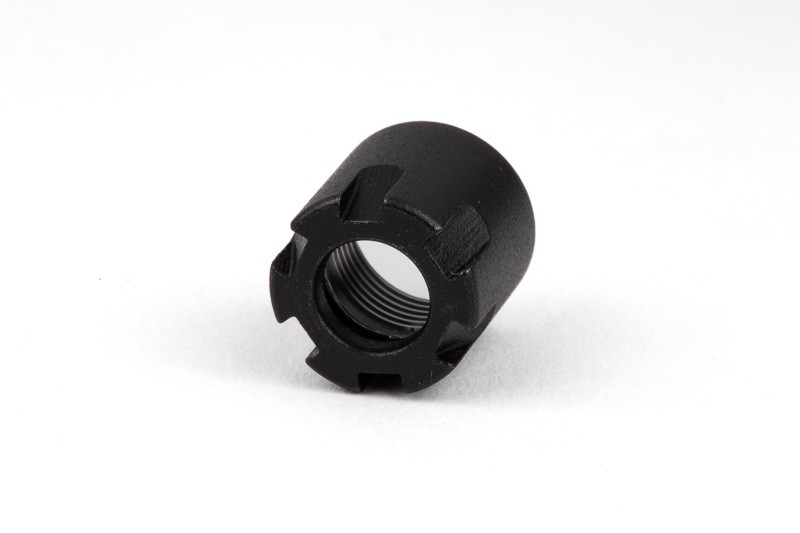

ER8M Collet Nut
Part #: 06-0169
