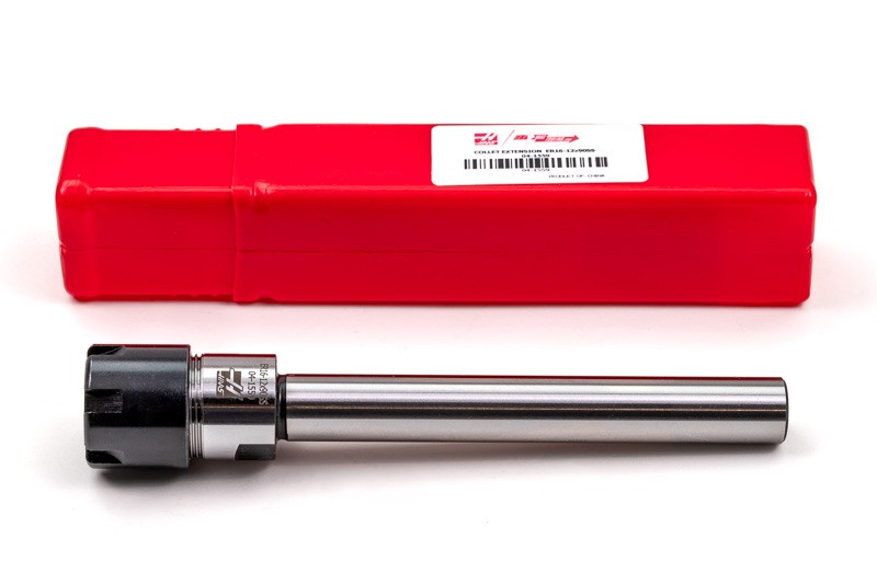

ER16M 12mm Straight Shank Collet Chuck x 90mm Short Shank Length, TSC
Part #: 04-1559
ER16-12x90SS
Price: 52.95 ( / unit)
Price: 1248.95 ( / unit)
Price: 371.95 ( / unit)
Price: 49.95 ( / unit)
Price: 224.95 ( / unit)
Price: 524.95 ( / unit)

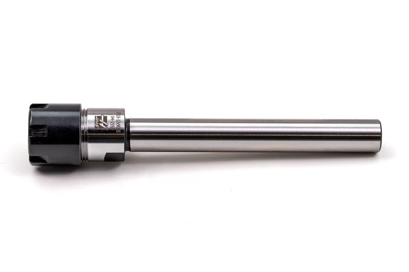

This straight shank ER16M collet extension accepts a variety of ER16M collet styles, and has a 12mm shank, with a 90mm short shank length. It is primarily used as an extended-length milling collet, by clamping it into the appropriate end mill holder. The double-taper collet design provides high clamping force for round, smooth shank tools, and offers a wide gripping range with excellent TIR and balance.
Collet Series ER-16
[ØBD] Body Diameter 22.0 mm
[ØDMM] Shank Diameter 12.0 mm
[LS] Shank Length 90.0 mm
[OAL] Overall Length 128.0 mm
[FS] Flat Size 8.485 mm
[TP1] Thread M5X0.8
Concentricity 0.0004"
Through Tool Coolant Yes
Weight 0.3 lbs \ 0.1 kg
