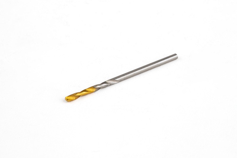

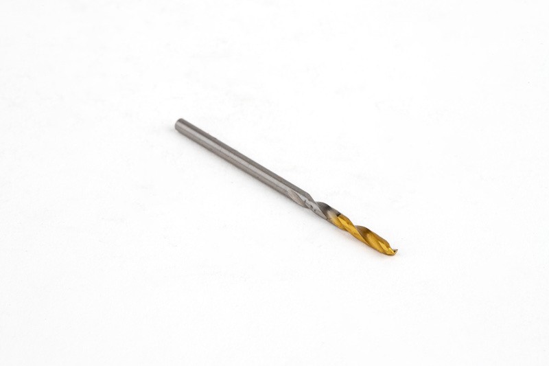

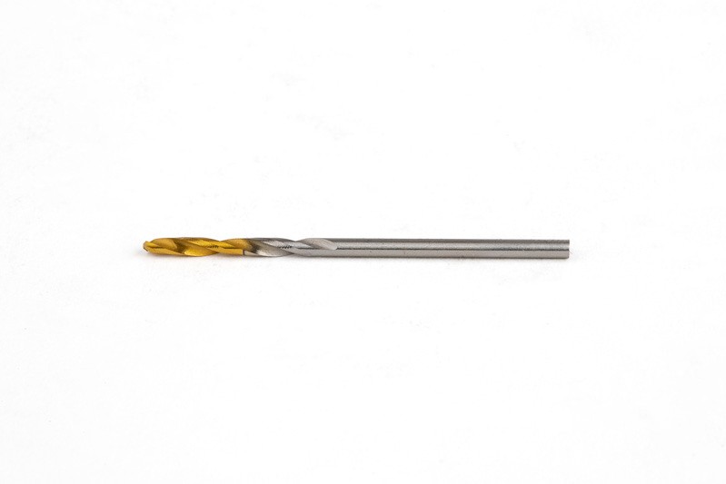

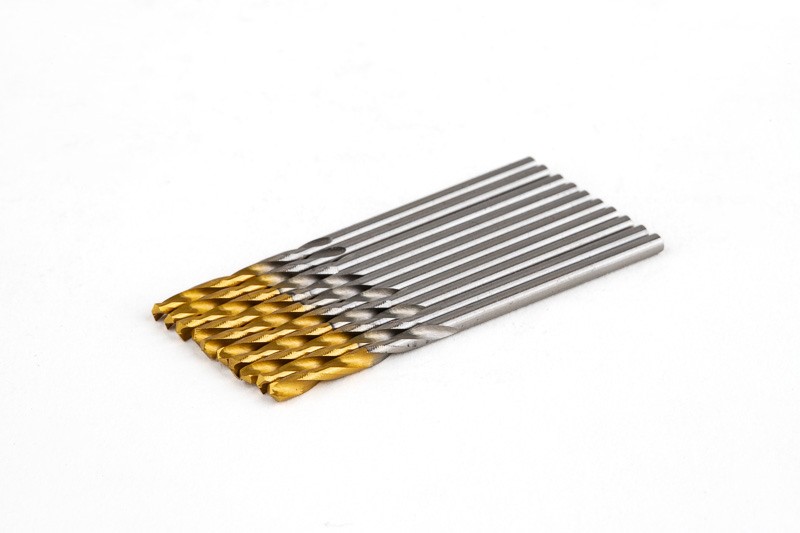

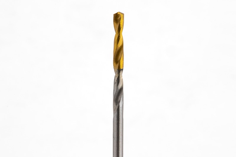

#44 Ø Cobalt Stub Drill, 135° Point Angle x 30° Helix, 2 Flute, TiN Coated - Pack of 10
Part #: 03-2386
CB SBD 2FL #44x.086x3/4x1-3/4,TIN
Price: 13.95 ( / unit)
7.97
ISO MATERIAL CHART
Drill Type Number
Secondary Workpiece Material K - Cast Iron, N - Aluminum, S - High Temp Alloys
Material HSSCo8 (M42)
Coating TiN
[D1] Drill Diameter 0.086 in \ #44
[ØDMM] Shank Diameter 0.086 in
[LU] Usable Length 0.682 in
[LCF] Flute Length 0.75 in
[PL] Point Length 0.018 in
[OAL] Overall Length 1.75 in
[NOF] Number of Flutes 2
[SIG°] Point Angle 135
[FHA°] Helix Angle 30
Drill Length Type Stub
Hole Tolerance h8
Cutting Direction Right
Through Spindle Coolant No
