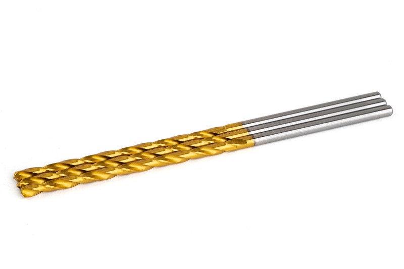

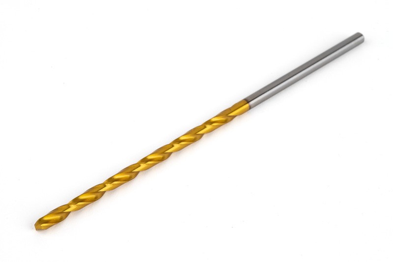

11/64" Ø Cobalt Taper-Length Drill, 135° Point Angle x 30° Helix, 2 Flute, TiN Coated - Pack of 3
Part #: 03-2525
CB TD 2FL 11/64x.172x3-3/8x5-3/4 TIN
Price: 25.95 ( / unit)
18.97
  • Speeds and Feeds
ISO MATERIAL CHART
Drill Type Fraction
Primary Workpiece Material M - Stainless Steel, P - Steel
Secondary Workpiece Material S - High Temp Alloys, N - Aluminum, K - Cast Iron
Material HSSCo8 (M42)
Coating TiN
[D1] Drill Diameter 0.1719 in \ 11/64"
[ØDMM] Shank Diameter 0.1719 in
[LU] Usable Length 3.203 in
[LCF] Flute Length 3.375 in
[PL] Point Length 0.036 in
[OAL] Overall Length 5.75 in
[NOF] Number of Flutes 2
[SIG°] Point Angle 135
[FHA°] Helix Angle 30
Drill Length Type Taper
Hole Tolerance h8
Cutting Direction Right
Through Spindle Coolant No
