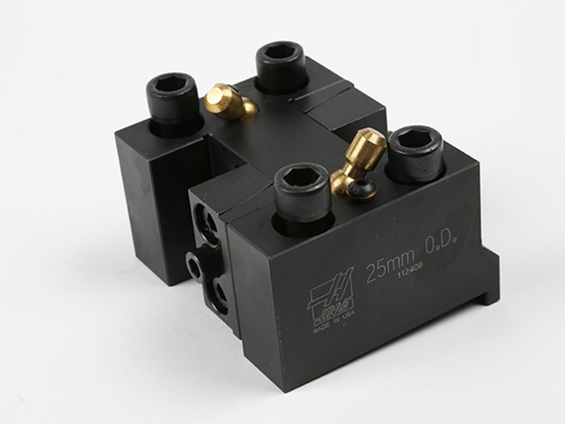

This BOT20 external (OD) twin static turning holder securely clamps 25mm square shank tools for use in Haas machines equipped with 12-station VB20/30 hybrid (BOT20/VDI40) turrets.
**This holder is only suitable for 12-station VB20/30 hybrid (BOT20/VDI40) turrets, and will NOT fit 12-station BOT20 bolt-on turrets.
  • 3D Model
Machine Models ST-28, ST-30, ST-25, ST-20, ST-20Y, ST-25Y, ST-30Y, ST-20L, ST-35, ST-30LY, ST-25LY, ST-20LY, ST-30L, ST-35LY, ST-25L, ST-35L, ST-35Y, ST-28Y, ST-28LY, ST-28L
Turret Style VB Hybrid
Turret Stations 12-Station
Main Spindle Turret VB20/30
Sub-Spindle Turret VB20/30
Toolholder Series BOT20
Holder Type External Turning
[S] Tool Shank Size 25.0 mm
[BH] Body Height 54.61 mm
[OAL] Overall Length 91.44 mm
[OAW] Overall Width 101.6 mm
[OAH] Overall Height 60.96 mm
[a] Dimension 45.0 mm
[b] Dimension 80.01 mm
[TP1] Thread M12x1.75
[TP2] Thread M8x1.25
Weight 5.3 lbs \ 2.4 kg
Country of Origin USA
