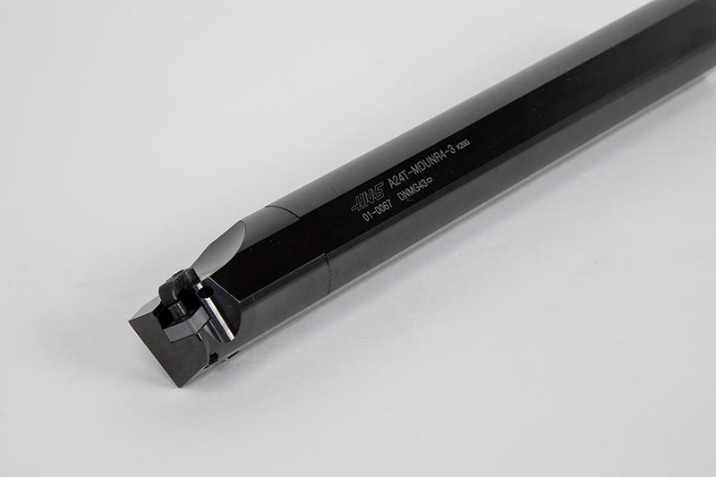

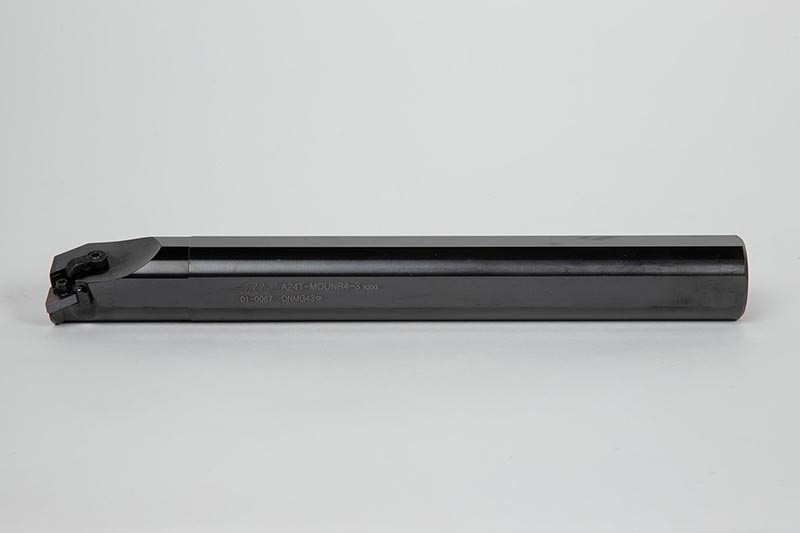

A24T-MDUNR4-3, 1-1/2" Ø Steel Shank Internal (ID) Boring Bar, Right-Hand, Multi-Lock, Through-Tool Coolant
Part #: 01-0067
A24T-MDUNR4-3
Customer Rating:
Price: $188.95 ( / unit)
$113.97
$108.27 (Save 5%)
Technical Documents

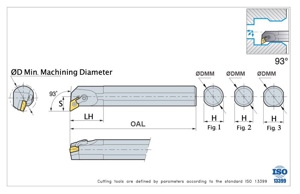

Type of Bar A - Steel Bar + Coolant
Clamping Type M - Multi-Lock
Tool Orientation Internal
Hand of Tool Right
Insert Style D Style - 55° Rhombic
Insert Size DNㅁㅁ43ㅁ / DNㅁㅁ1504ㅁㅁ
[ØD] Min. Machining Diameter 2.0 in
[ØDMM] Shank Diameter 1.5 in
[LH] Head Length 2.362 in
[OAL] Overall Length 12.0 in
[H] Shank Height  1.382 in
[S] Center to Insert Dimension 0.89 in
[°] Lead Angle 93 Degree
Figure 3

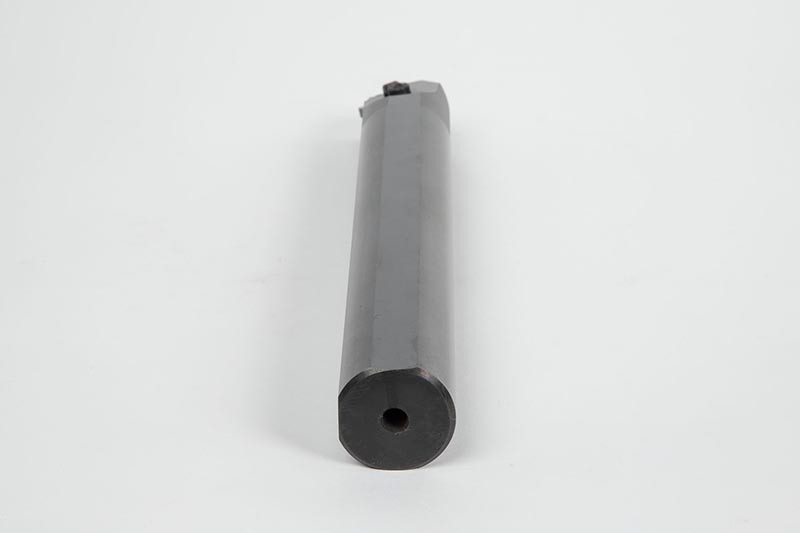

Through Tool Coolant Yes
Weight 5.4 lbs \ 2.5 kg
