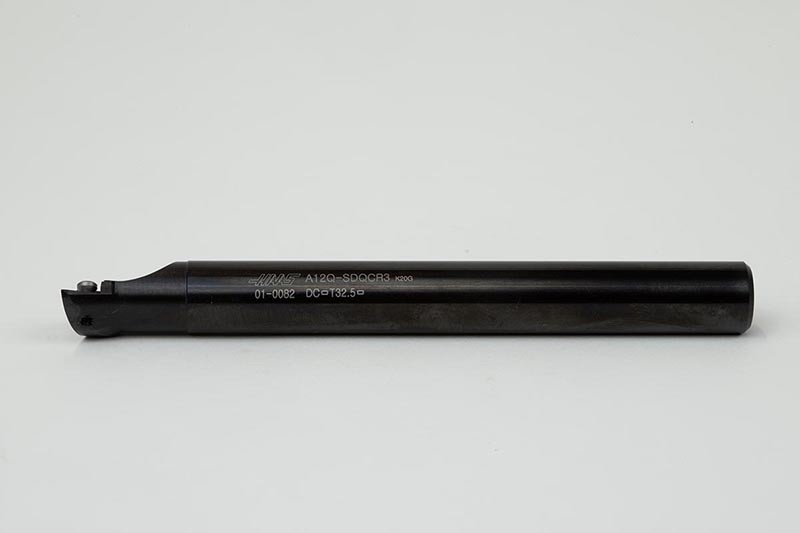

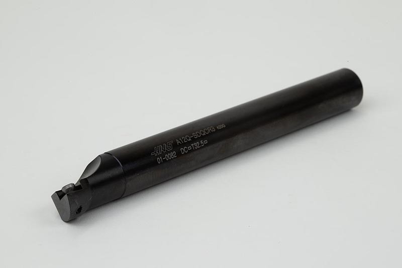

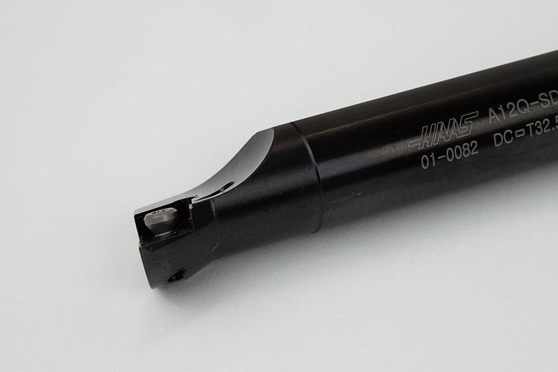

A12Q-SDQCR3, 3/4" Ø Steel Shank Internal (ID) Boring Bar, Right-Hand, Screw-Lock, Through-Tool Coolant
Part #: 01-0082
A12Q-SDQCR3
Price: 103.95 ( / unit)
62.97
Technical Documents
Type of Bar A - Steel Bar + Coolant
Clamping Type S - Screw-On
Tool Orientation Internal
Hand of Tool Right
Insert Style D Style - 55° Rhombic
Insert Size DCㅁㅁ325ㅁ / DCㅁㅁ11T3ㅁㅁ
[ØD] Min. Machining Diameter 0.98 in
[ØDMM] Shank Diameter 0.75 in
[LH] Head Length 1.26 in
[OAL] Overall Length 7.0 in
[H] Shank Height  0.711 in
[S] Center to Insert Dimension 0.562 in
[°] Lead Angle 108 Degree
[D1] Insert Hole Size 0.173 in \ 4.4 mm
Figure 1
Through Tool Coolant Yes
Weight 0.8 lbs \ 0.4 kg
