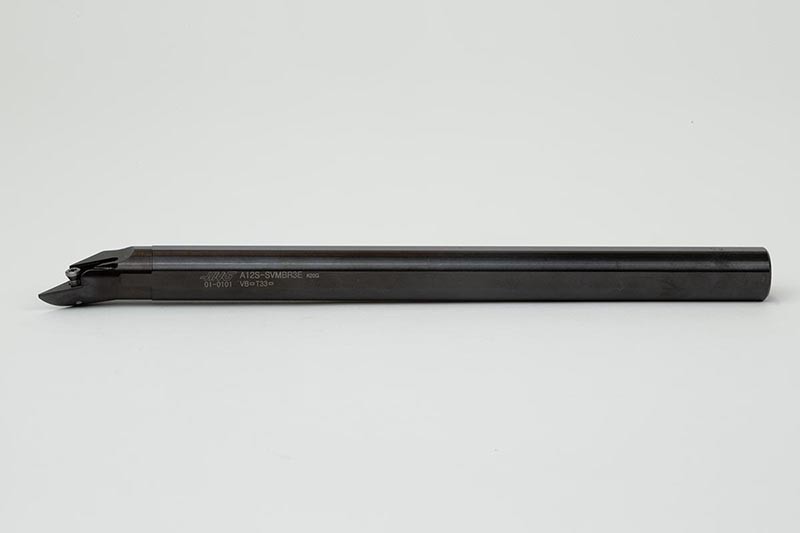

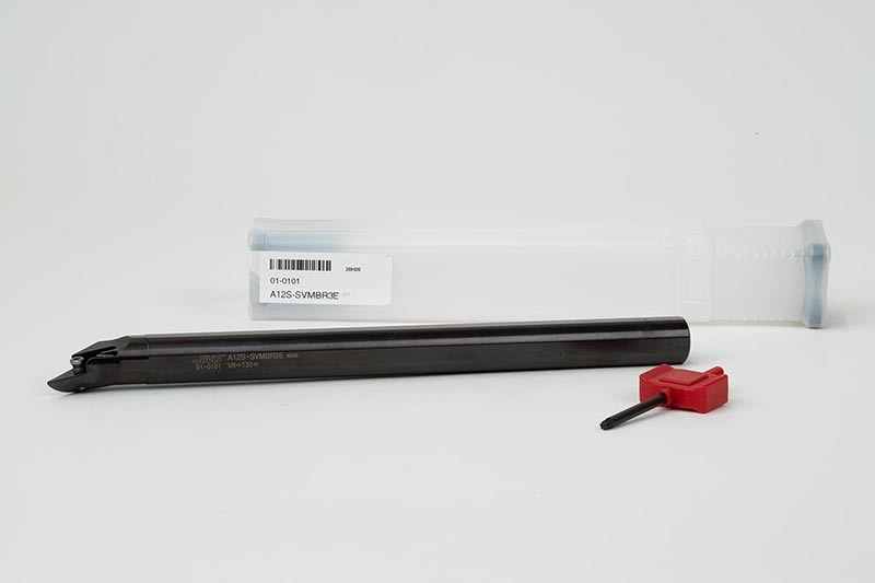

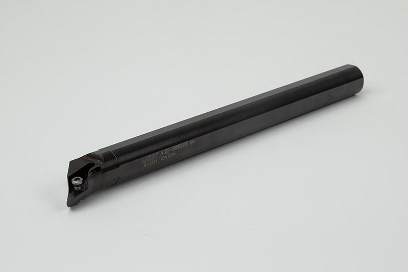

A12S-SVMBR3E, 3/4" Ø Steel Shank Internal (ID) Boring Bar, Right-Hand, Screw-Lock, Through-Tool Coolant
Part #: 01-0101
A12S-SVMBR3E
Customer Rating:
Price: $115.95 ( / unit)
$69.97
$66.47 (Save 5%)
Technical Documents
Type of Bar A - Steel Bar + Coolant
Clamping Type S - Screw-On
Tool Orientation Internal
Hand of Tool Right
Insert Style V Style - 35° Rhombic
Insert Size VBㅁㅁ33ㅁ / VBㅁㅁ1604ㅁㅁ
[ØD] Min. Machining Diameter 1.286 in
[ØDMM] Shank Diameter 0.75 in
[LH] Head Length 1.5 in
[OAL] Overall Length 10.0 in
[H] Shank Height  0.711 in
[S] Center to Insert Dimension 0.5 in
[°] Lead Angle 140 Degree
[D1] Insert Hole Size 0.173 in \ 4.4 mm
Figure 1
Through Tool Coolant Yes
Weight 1.1 lbs \ 0.5 kg
