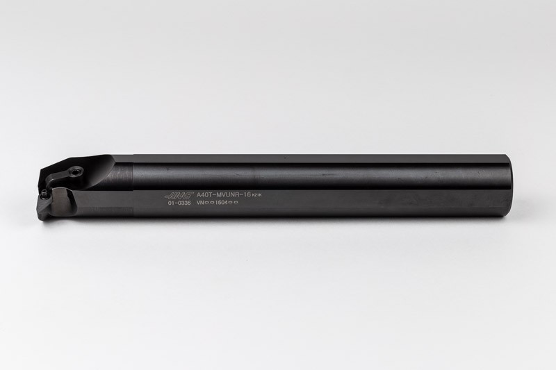

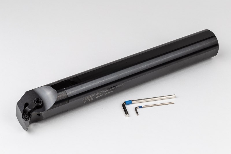

A40T-MVUNR-16, 40mm Ø Steel Shank Internal (ID) Boring Bar, Right-Hand, Multi-Lock, Through-Tool Coolant
Part #: 01-0336
A40T-MVUNR-16
Price: 241.95 ( / unit)
Price: 3573.95 ( / unit)
Price: 1063.95 ( / unit)
Price: 142.95 ( / unit)
Price: 643.95 ( / unit)
Price: 1500.95 ( / unit)
169.97
2524.97
751.97
100.97
454.97
1060.97
Type of Bar A - Steel Bar + Coolant
Clamping Type M - Multi-Lock
Tool Orientation Internal
Hand of Tool Right
Insert Style V Style - 35° Rhombic
Insert Size VNㅁㅁ33ㅁ / VNㅁㅁ1604ㅁㅁ
[ØD] Min. Machining Diameter 50.0 mm
[ØDMM] Shank Diameter 40.0 mm
[LH] Head Length 60.0 mm
[OAL] Overall Length 300.0 mm
[H] Shank Height  38.0 mm
[S] Center to Insert Dimension 27.0 mm
[°] Lead Angle 93 Degree
[D1] Insert Hole Size 0.15 in \ 3.81 mm
[L10] Cutting Edge Length 0.654 in \ 16.61 mm
Figure 3
Through Tool Coolant Yes
Weight 5.9 lbs \ 2.7 kg
