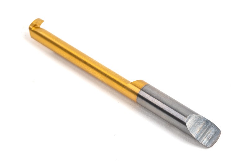

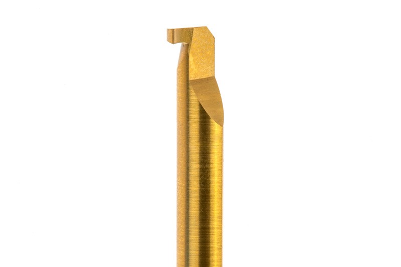

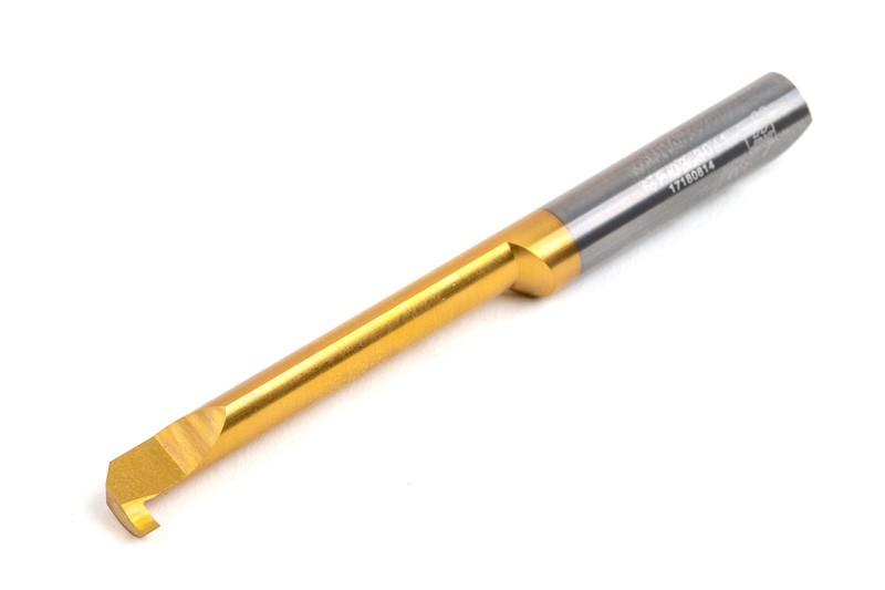

HMG-6, 6mm Ø Carbide Internal (ID) Micro Grooving Tool, 1.5mm Cut Width x 35mm Head Length, Right-Hand
Part #: 03-3041
MICRO TURN, HMG-6R6.2-35-150-18 TIN
Price: $29.95 ( / unit)
Price: 623.95 ( / unit)
Price: 185.95 ( / unit)
Price: 24.95 ( / unit)
Price: 112.95 ( / unit)
Price: 261.95 ( / unit)
$23.97
449.97
133.97
17.97
80.97
188.97
$22.77 (Save 5%)
ISO MATERIAL CHART
Type Tool
Toolpath Type ID Groove
Tool Orientation Internal
Hand of Tool Right
Insert Style HMG - Grooving
Secondary Workpiece Material M - Stainless Steel, S - High Temp Alloys
Material Carbide
Coating TiN
Connection Size 6
[ØD] Min. Machining Diameter 0.244 in \ 6.2 mm
[ØDMM] Shank Diameter 0.236 in \ 6.0 mm
[LH] Head Length 1.378 in \ 35.0 mm
[OAL] Overall Length 2.48 in \ 63.0 mm
[OHX] Maximum Overhang 1.59 in \ 40.5 mm
[CW] Cutting Width 0.059 in \ 1.5 mm
[T-MAX] Maximum Depth 0.071 in \ 1.8 mm
[S] Center to Insert Dimension 0.116 in \ 2.95 mm
