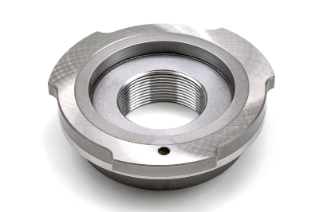

HQCBD-52, Dead Length Collet Chuck for A2-5 Spindle Nose, M35x1.5 Drawbar Nut
Part #: 08-2079
HQCBD-52 A2-5 M35x1.5
Price: $2,649.95 ( / unit)
Price: 66248.95 ( / unit)
Price: 19715.95 ( / unit)
Price: 2649.95 ( / unit)
Price: 11924.95 ( / unit)
Price: 27824.95 ( / unit)
Reduce your lathe set-up times with this Haas quick-change collet chuck. Collets are changed in seconds, using a handheld collet changing tool (not included), making the changeover from one size material to another fast and easy. This dead length style A2-5 collet chuck is compatible with Haas ST-10 to ST-28 lathe Sub Spindles . Accepts a wide range of quick-change collets, in smooth and serrated styles (not included).
Haas Collet Chuck 65
____________________________
  • Dead length collet chuck
  • Compatible with  Haas ST lathe Sub Spindles
  • Collet changes in seconds (requires handheld collet changing tool)
  • High clamping accuracy and rigidity
  • Sealed design for long life and minimal maintenance
  • Uses rubber grip collets for better grip and larger gripping range
*VERIFY YOUR DRAWTUBE THREAD SIZE*
This collet chuck will only fit on Haas ST-10 to ST-28 lathe Sub Spindles that feature an M35 thread. Please refer to the layout drawing of your machine to verify the drawtube thread on your machine to ensure an accurate fit.
Technical Documents
  • Chuck and Spindle Nose Comparison Chart
  • Setup Manual
Type Collet Chuck
Collet Type Dead Length Collet Chuck
Machine Models ST-15 Sub, ST-28 Sub, ST-20 Sub, ST-10 Sub
Collet Series HRG-52R, HRG-52RT
Spindle Nose A2-5
[ØD] Bore Diameter 2.09 in \ 53.0 mm
[ØBD] Body Diameter 5.51 in \ 140.0 mm
[ØA] Flange Diameter 5.51 in \ 140.0 mm
[ØB] Nose Diameter 4.57 in \ 116.0 mm
[ØF] Spindle Nose Diameter 3.25 in \ 82.56 mm
[C] Flange Length 2.64 in \ 67.0 mm
[E] Nose Length 39.8 in \ 1.57 mm
[OAL] Overall Length 4.29 in \ 109.0 mm
[G] Throat Depth 2.05 in \ 52.0 mm
Draw Nut Thread Size M35x1.5
Concentricity 0.0004 in \ 0.01 mm
Maximum Collet Capacity 2.05 in \ 52.0 mm
Minimum Collet Capacity 0.157 in \ 4.0 mm
Maximum RPM 7000
Maximum Clamping Force 20704.1 lbs \ 92.1 kN
Weight 21.03 lbs \ 9.53 kg
Country of Origin Taiwan
