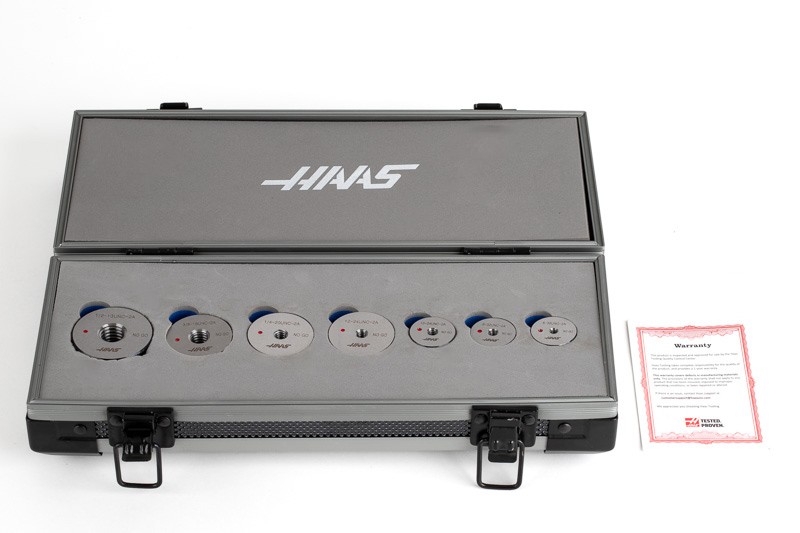

7-Piece, NO-GO Thread Ring Gauge Set, Inch
Part #: 09-0471
THREAD RING GAUGE Set/NO-GO 7pcs INCH
Price: 180.95 ( / unit)
117.97

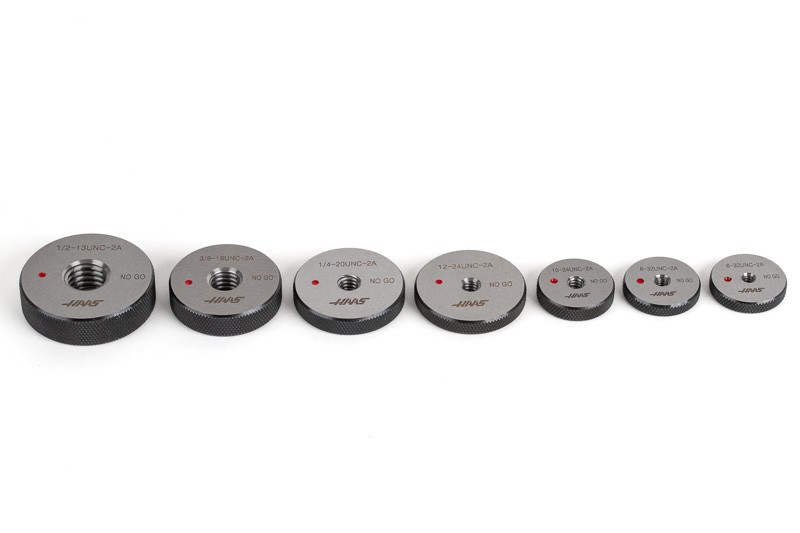

This 7-piece inch NO-GO thread ring gauge set is a collection of precision tools used to check the pitch diameter and thread quality of screws or externally threaded parts by threading the parts into the respective gauges to verify if the threads meet the required specifications within the acceptable tolerance range for "NO-GO" testing. This set includes a #6-32, #8-32 , #10-24 , #12-24 , 1/4"-20 , 3/8"-16 , and 1/2"-13.
Type Thread Ring Gauge Set
Thread Size #10-24, 1/2"-13, #8-32, 1/4"-20, #12-24, 3/8"-16, #6-32
Gauge Type NO-GO
Number of Pieces 7
Thread Class 2A
Thread Tolerance ± 0.00016 in
Rockwell Hardness 58.0 - 63.0 HRC
Material Hard Steel
Standard ANSI B1.2
Weight 1.7 lbs \ 0.8 kg
Inspection Report (Y/N) Y
