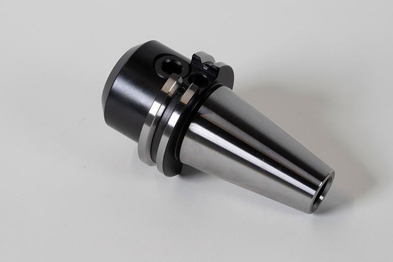

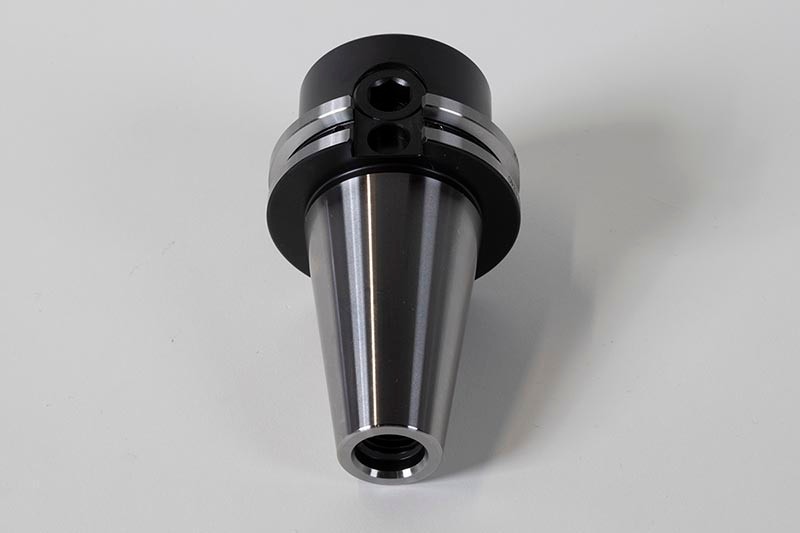

This CAT40 end mill holder has a 1.25 in \ 1-1/4" bore diameter and a 2" gage length. It uses the Weldon flat standard with side-lock clamping for secure clamping of cutting tools. It is through-tool coolant (TSC) capable, with a 5/8"-11 pull stud/retention knob thread.
Taper CT40
[ØD] Bore Diameter 1.25 in \ 1-1/4"
[ØBD] Body Diameter 2.25 in
[ØBD2] Minimum Body Diameter 1.91 in
[GL] Gage Length 2.0 in
[BL] Body Length 1.25 in
[TP1_L] Thread Location 1.125 in
[TP1] Thread 3/4"-16
Concentricity 0.0002 in
Balanced to RPM 20,000
Bore Tolerance H5
Retention Knob Thread Size 5/8"-11
Through Tool Coolant Yes
Spindle Drive Slots Yes
Weight 2.2 lbs \ 1.0 kg
