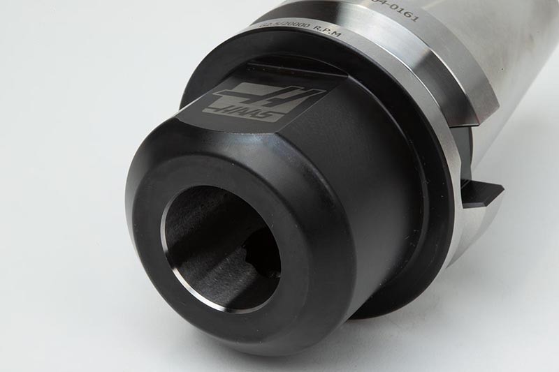

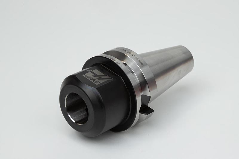

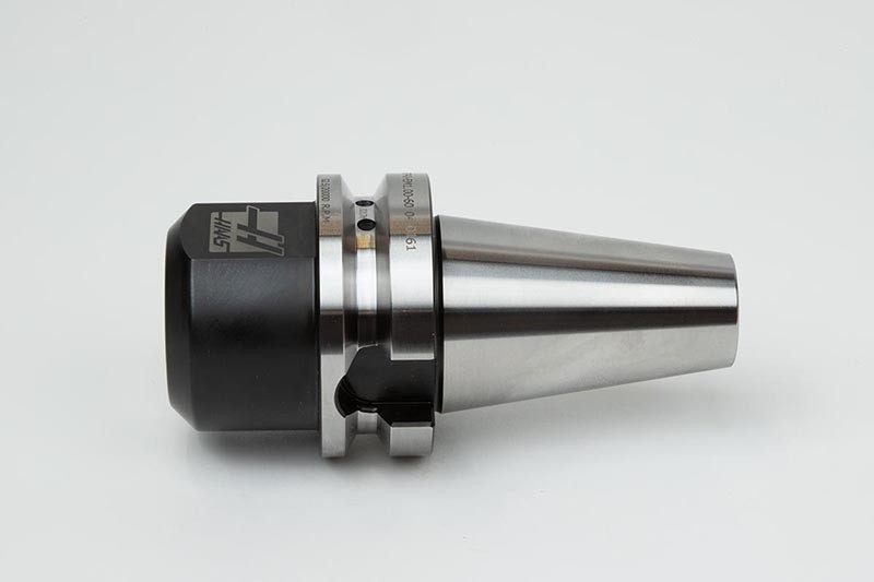

BT40 1" End Mill Holder x 60mm Gage Length, TSC
Part #: 04-0161
BT40-EM-1.0-2.36
Price: 69.95 ( / unit)
45.97
This BT40 end mill holder has a 1.0 in \ 1" bore diameter and a 60mm gage length. It uses the Weldon flat standard with side-lock clamping for secure clamping of cutting tools. It is through-tool coolant (TSC) capable, with a M16x2.0 pull stud/retention knob thread.
Taper BT40
[ØD] Bore Diameter 1.0 in \ 1"
[ØBD] Body Diameter 2.0 in
[ØBD2] Minimum Body Diameter 1.5 in
[GL] Gage Length 2.36 in
[BL] Body Length 1.299 in
[TP1_L] Thread Location 0.945 in
[TP1] Thread 3/4"-16
Concentricity 0.0002 in
Balanced to RPM 20000
Bore Tolerance H5
Retention Knob Thread Size M16X2.0
Through Tool Coolant Yes
Spindle Drive Slots Yes
Weight 2.6 lbs \ 1.2 kg
