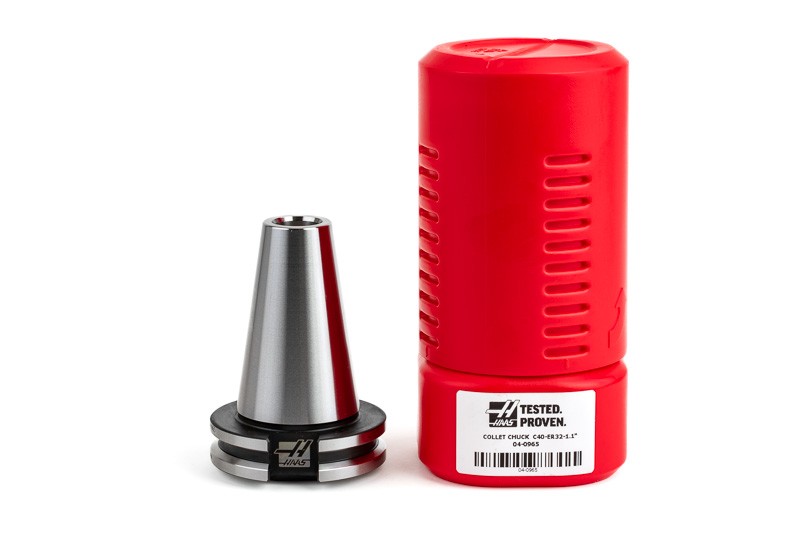

This CAT40 ER32 collet chuck accepts a variety of ER32 collet styles, and has a 1.1" gage length. The double-taper collet design provides high clamping force for round, smooth shank tools, and offers a wide gripping range with excellent TIR and balance. It is through-tool coolant (TSC) capable, with a 5/8"-11 pull stud/retention knob thread.

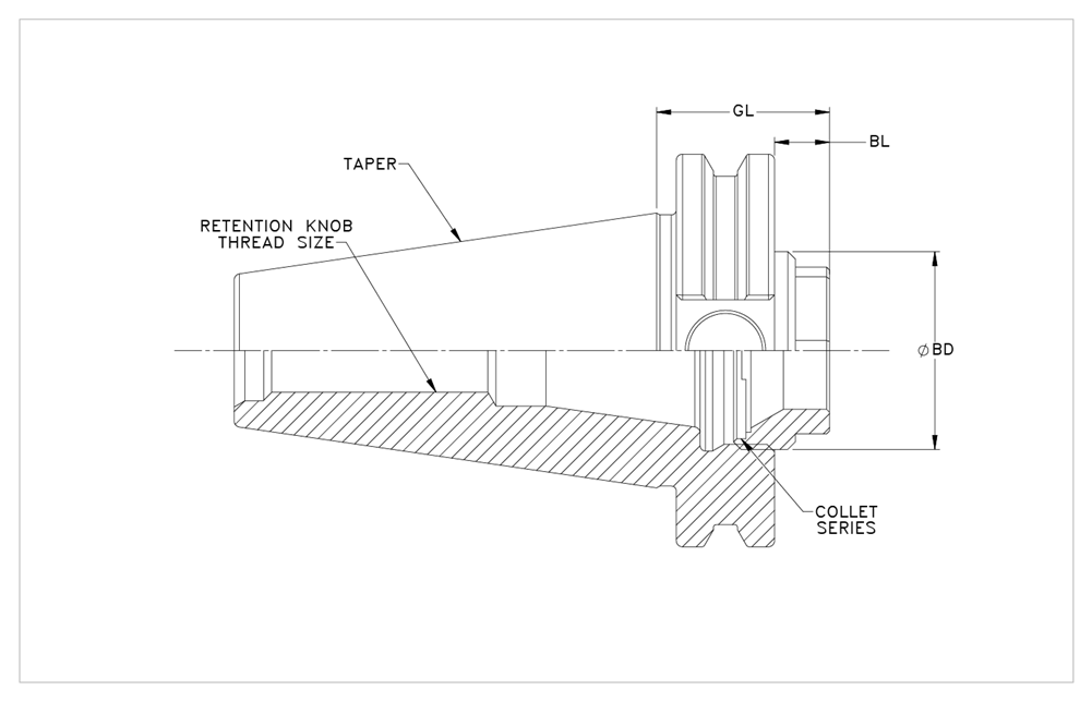

Taper CT40
Collet Series ER-32
[ØBD] Body Diameter 1.575 in
[GL] Gage Length 1.1 in
[BL] Body Length 0.35 in
Concentricity 0.0001 in
Balanced to RPM 25000
Retention Knob Thread Size 5/8"-11
Through Tool Coolant Yes
Spindle Drive Slots Yes
Weight 2.2 lbs \ 1.0 kg
