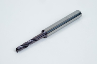

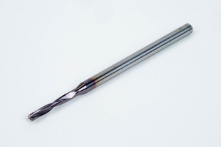

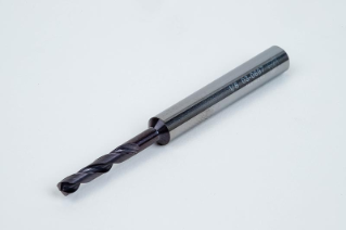

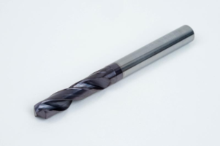

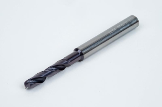

1/16" Ø Carbide Drill, 3mm Shank x 140° Point Angle x 17° Helix, 3XD, 2 Flute, TiAlN Coated, GP
Part #: 03-0685
PRICE IF PURCHASED SEPARATELY:
Quantity: 1
5/64" Ø Carbide Drill, 3mm Shank x 140° Point Angle x 17° Helix, 3XD, 2 Flute, TiAlN Coated, GP
Part #: 03-0686
Quantity: 1
3/32" Ø Carbide Drill, 4mm Shank x 140° Point Angle x 18° Helix, 3XD, 2 Flute, TiAlN Coated, GP
Part #: 03-0688
Quantity: 1
7/64" Ø Carbide Drill, 4mm Shank x 140° Point Angle x 19° Helix, 3XD, 2 Flute, TiAlN Coated, GP
Part #: 03-0693
Quantity: 1
9/64" Ø Carbide Drill, 6mm Shank x 140° Point Angle x 30° Helix, 3XD, 2 Flute, TiAlN Coated, GP
Part #: 03-0701
Quantity: 1
1/8" Ø Carbide Drill, 6mm Shank x 140° Point Angle x 30° Helix, 3XD, 2 Flute, TiAlN Coated, GP
Part #: 03-0697
Quantity: 1
5/32" Ø Carbide Drill, 6mm Shank x 140° Point Angle x 30° Helix, 3XD, 2 Flute, TiAlN Coated, GP
Part #: 03-0705
Quantity: 1
3/16" Ø Carbide Drill, 6mm Shank x 140° Point Angle x 30° Helix, 3XD, 2 Flute, TiAlN Coated, GP
Part #: 03-0713
Quantity: 1
7/32" Ø Carbide Drill, 6mm Shank x 140° Point Angle x 30° Helix, 3XD, 2 Flute, TiAlN Coated, GP
Part #: 03-0717
Quantity: 1
11/64" Ø Carbide Drill, 6mm Shank x 140° Point Angle x 30° Helix, 3XD, 2 Flute, TiAlN Coated, GP
Part #: 03-0711
Quantity: 1
1/4" Ø Carbide Drill, 8mm Shank x 140° Point Angle x 30° Helix, 3XD, 2 Flute, TiAlN Coated, GP
Part #: 03-0720
Quantity: 1
15/64" Ø Carbide Drill, 6mm Shank x 140° Point Angle x 30° Helix, 3XD, 2 Flute, TiAlN Coated, GP
Part #: 03-0718
Quantity: 1

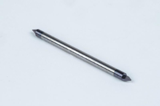

Carbide Engraving Cutter, Double End, 1 Flute, Uncoated, 1/8" Smooth Shank x 1/8" LOC, 0.021" Radius
Part #: 03-2103
Quantity: 1
Carbide Engraving Cutter, Double End, 1 Flute, TiAlN Coated, 1/8" Smooth Shank x 1/8" LOC, 0.021" Radius
Part #: 03-2104
Quantity: 1

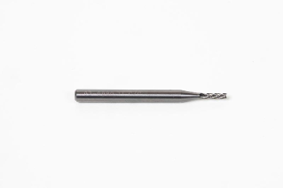

3/16" Dia. Carbide End Mill, 3 Flute, DLC Coated, 3/16" Smooth Shank x 9/16" LOC, 0.01" Radius, HSAM2
Part #: 03-1922
Quantity: 1
1/8" Dia. Carbide End Mill, 3 Flute, DLC Coated, 1/8" Smooth Shank x 3/8" LOC, 0.01" Radius, HSAM2
Part #: 03-1921
Quantity: 1
1/16" Dia. Carbide End Mill, 3 Flute, Uncoated, 1/8" Smooth Shank x 3/16" LOC, Square Profile, HSAM1
Part #: 03-0080
Quantity: 1
Matt Nelson
Jan 22 2024
What diameter bit does the ER11 collet hold that the Desktop Mill comes with?
1 Answers
Haas Tooling Support
Jan 22 2024
Hi Matt, this 15-piece Set of metric straight-bore ER11 collets includes sizes from 1mm to 8mm, in 0.5mm increments, allowing you to securely clamp round-shank tools from 0.5mm - 8mm (0.020 - 0.315") diameter.
