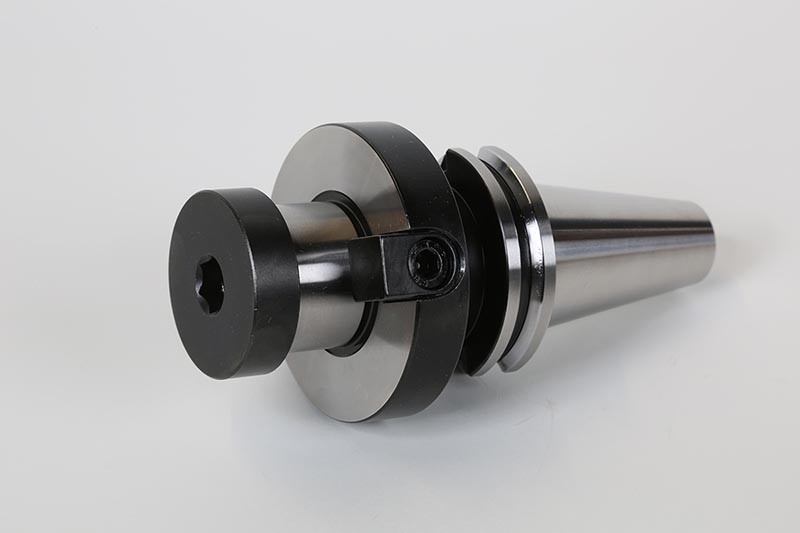

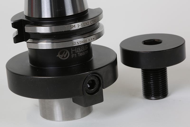

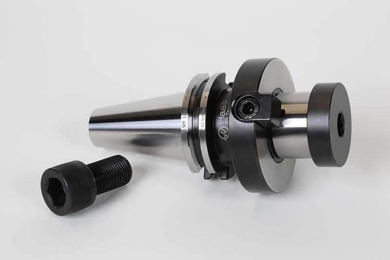

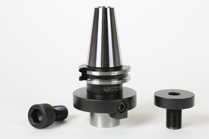

This CAT40 shell mill holder has a 1.5 in \ 1-1/2" pilot bore and a 2" gage length. It is constructed of hardened alloy steel, and designed to hold a variety of arbor-style shell mill and face mill cutters. The drive keys are removable for added versatility. Includes a solid arbor screw; a coolant-through arbor screw is required for through-tool coolant (TSC) cutters. This holder has a 5/8"-11 pull stud/retention knob thread.

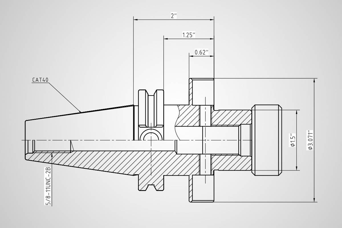

Taper CT40
[ØPD] Pilot Diameter 1.5 in \ 1-1/2"
[ØBD] Body Diameter 3.07 in
[GL] Gage Length 2.0 in
[BL] Body Length 0.62 in
[PL] Pilot Length 0.938 in
[DH] Drive Lug Height 0.313 in
[a] Keyway Width 0.625 in
[TP1] Thread 3/4"-16
Concentricity 0.0004 in
Balanced to RPM 20,000
Retention Knob Thread Size 5/8"-11
Through Tool Coolant Yes
Spindle Drive Slots Yes
Weight 4.9 lbs \ 2.2 kg
