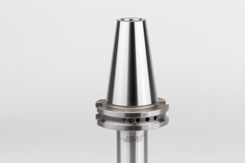

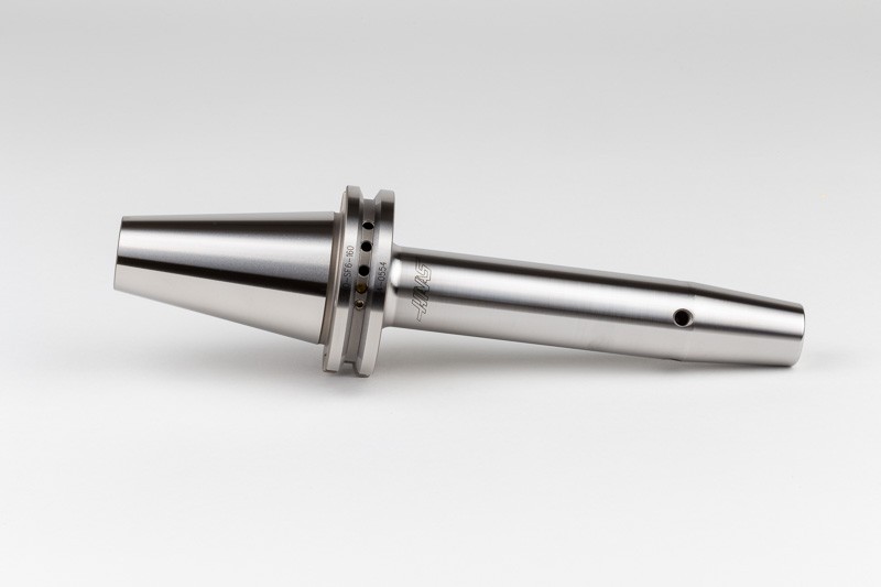

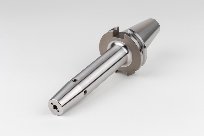

This SK40 \ DIN 69871 shrink fit holder has a 6mm bore diameter, and a 160mm gage length. It offers very low runout (0.003mm TIR), very high grip force, and quick tool changeovers when used in conjuction with Haas shrink fit machines. It is through-tool coolant (TSC) capable, with a M16x2.0 pull stud/retention knob thread.
Taper SK40 \ DIN 69871
[ØD] Bore Diameter 6.0 mm
[ØBD2] Minimum Body Diameter 21.0 mm
[ØBD] Maximum Body Diameter 27.0 mm
[GL] Gage Length 160.0 mm
[OAL] Overall Length 228.4 mm
[LSCN] Minimum Clamping Length 26.0 mm
[LSCX] Maximum Clamping Length 36.0 mm
[SIG°] Angle 4.5 °
Concentricity 0.003 mm
Balanced to RPM 25000
Retention Knob Thread Size M16X2.0
Through Tool Coolant Yes
Spindle Drive Slots Yes
Weight 2.6 lbs \ 1.2 kg
