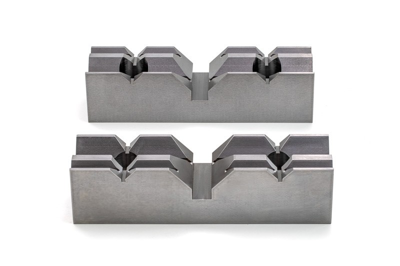

These hard steel V-groove vise jaws for Haas 8" vises are ideal for holding cylindrical workpieces. The jaws are 8" wide by 2.2" tall by 1.9" thick, with standard hole spacing and dimensions.
HOLD ROUND PARTS ON YOUR FIXED-JAW VISE
__________________________________________________________________________________
V-groove vise jaws are a great solution for holding round stock. Instead of machining custom soft jaws for every part or stock size – which takes extra time – these jaws can grip a wide range of diameters, making them a versatile addition to your shop. Plus, with multiple V-grooves, you can hold several pieces at once for even more machining efficiency.

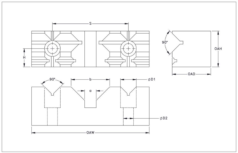

[ØD1] Counterbore Diameter 1.024 in \ 26.0 mm
[ØD2] Screw Hole Diameter 0.709 in \ 18.0 mm
[H] Height of Screw Hole 1.22 in \ 31.0 mm
[a] Dimension 0.591 in \ 15.0 mm
[b] Dimension 1.969 in \ 50.0 mm
[OAW] Overall Width 8.0 in \ 203.2 mm
[OAH] Overall Height 2.2 in \ 55.9 mm
[OAD] Overall Depth 1.969 in \ 50.0 mm
[S] Screw Spacing 4.75 in \ 120.7 mm
