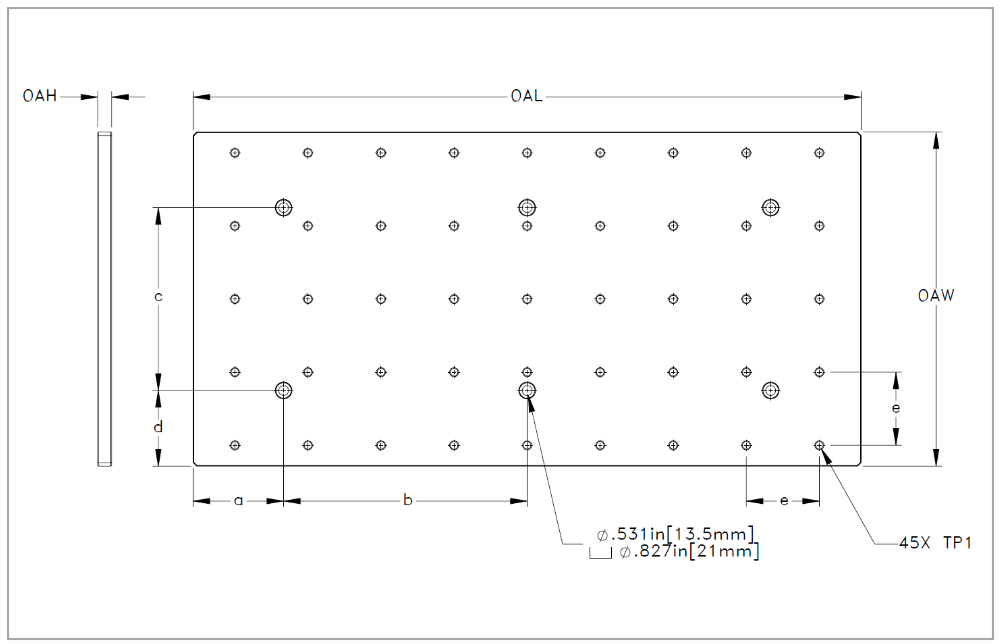

VF-2YT Rectangle Grid Steel Tooling Fixture Subplate, 18" Width x 36" Length
Part #: 08-1880
VF PLATE STEEL PATTERN W/ HARDWARE
Price: $881.95 ( / unit)
$749.97
  • These are designed to be used only with VF2YT machines and come with all hardware necessary to install to T-Slot table or Pallet
  • Machines with Renishaw Probes and Pallet Pool Systems built before 2024 will need updated Probe Mount, Please check your machine before ordering. Contact your HFO for more information.
Machine Models VF-2YT
Pallet Pool Compatible Yes
Plate Style Rectangle
Plate Design Grid
Material Steel
[OAL] Overall Length 36.0 in \ 914.4 mm
[OAW] Overall Width 18.0 in \ 457.2 mm
[OAH] Overall Height 0.748 in \ 19.0 mm
[a] Dimension 4.875 in \ 123.82 mm
[b] Dimension 13.125 in \ 333.37 mm
[c] Dimension 9.843 in \ 250.0 mm
[d] Dimension 4.079 in \ 103.6 mm
[e] Dimension 3.937 in \ 100.0 mm
[TP1] Thread M12x1.75
Parallelism 0.002 in \ 0.051 mm
Weight 134.5 lbs \ 61.0 kg
