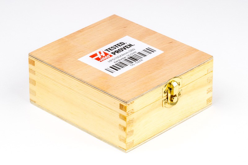

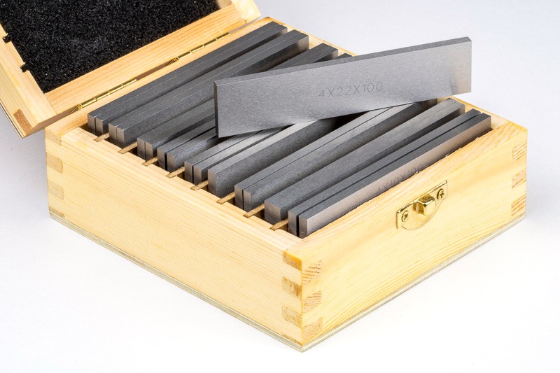

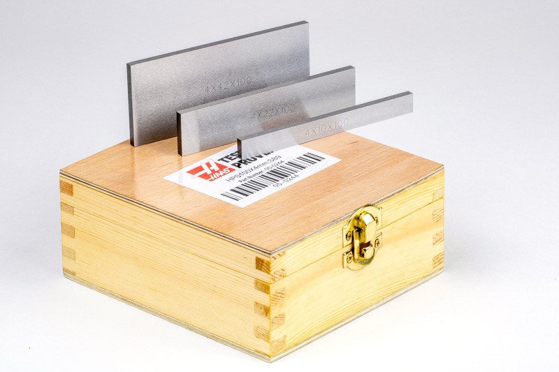

Hard Steel Blank Parallel Set, 100mm Length x 4mm Width, 10-42mm Height, 9 Pairs
Part #: 05-0244
HPS100X4mmSB9
Customer Rating:
Price: 78.95 ( / unit)
Price: 1873.95 ( / unit)
Price: 557.95 ( / unit)
Price: 74.95 ( / unit)
Price: 337.95 ( / unit)
Price: 786.95 ( / unit)
47.97
Parallels are comonly used to support workpieces clamped in a vise or to a machine table. This set is hardened to HRC 55-56 and ground to a parallelism within 0.005 mm.
Material Hard Steel
Type Blank
Number of Pairs 9
[L] Length 100.0 mm
[W] Width 4.0 mm
[H] Height 10.0 mm - 42.0 mm
Rockwell Hardness HRC 55-56
Parallelism 0.005 mm
Weight 3.8 lbs \ 1.7 kg

Juri
Feb 07 2023
Hi, What is a height of each parallel?
1 Answers
Haas Tooling
Feb 07 2023
Hi Juri, These parallels increase in height by 4mm increments so the heights of each parallel are as follows. 10mm, 14mm, 18mm, 22mm, 26mm, 30mm, 34mm, 38mm, and 42mm Thank you, Haas Tooling
