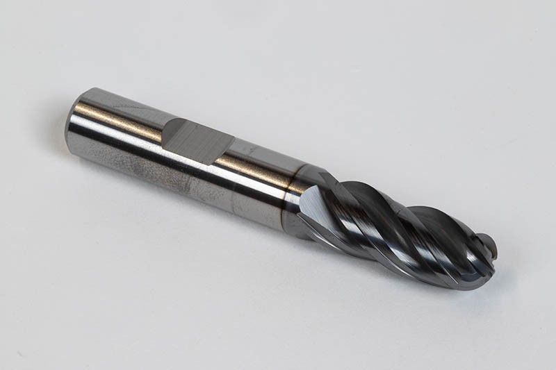

7/16" Dia. Carbide Ball End Mill, 4 Flute, Hyb. AlCrN Coated, 7/16" Weldon Shank x 1" LOC, HTPM
Part #: 03-0485
BNEM 7/16 X 7/16 X 1 X 2-3/4 WELDON FLAT
Price: 35.95 ( / unit)

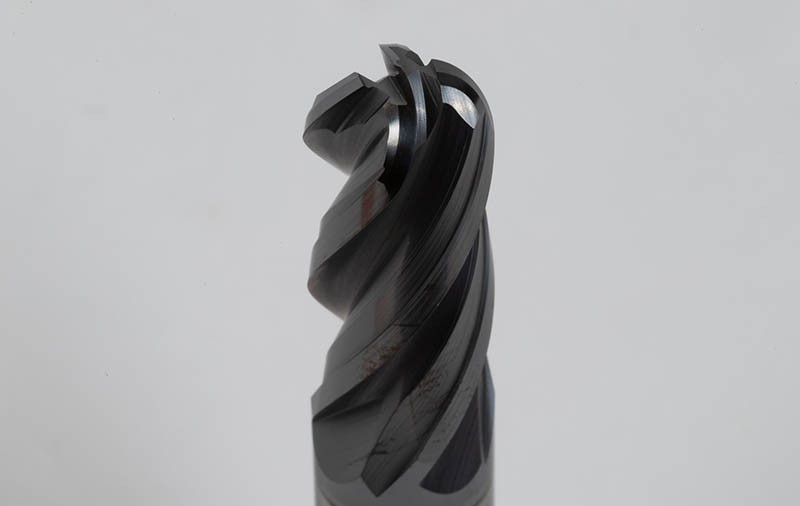

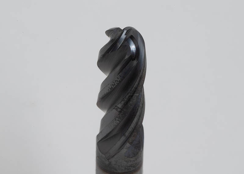

This HTPM 4-flute carbide ball end mill has a 0.4375 in \ 7/16" cutting diameter, with a 7/16" weldon shank, 1" length of cut (LOC), 7/32" ball radius, and a 2-3/4" overall length. It is hybrid AlCrN coated, and made to cut steel, stainless steel, and cast iron, but is capable of cutting some grades of high temp. alloys.
ISO Material Chart
Haas Milling Series HTPM
Primary Workpiece Material K - Cast Iron, P - Steel, M - Stainless Steel
Material Carbide
Coating Hybrid AlCrN
Corner Type Ball
Shank Type Weldon

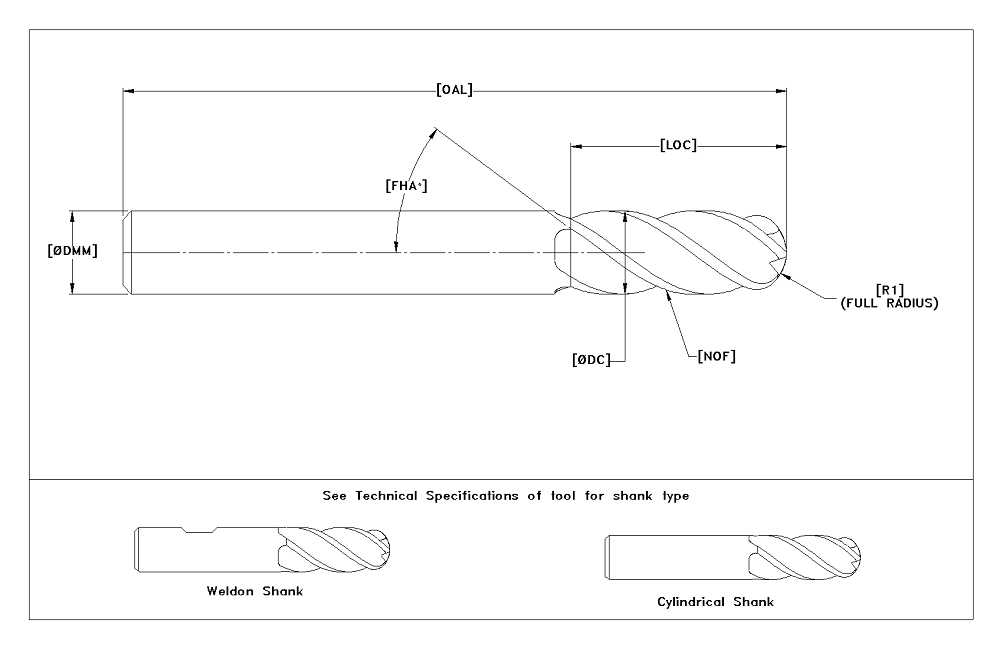

[ØDC] Cutting Diameter 0.4375 in \ 7/16"
[ØDMM] Shank Diameter 0.4375 in
[LOC] Length Of Cut 1.0 in
[OAL] Overall Length 2.75 in
[NOF] Number of Flutes 4
[R1] Radius 0.219 in
[FHA°] Helix Angle 35/37
Cutting Direction Right
Center Cutting Yes
Variable Pitch Yes
Through Spindle Coolant No
Weight 0.2 lbs \ 0.1 kg
