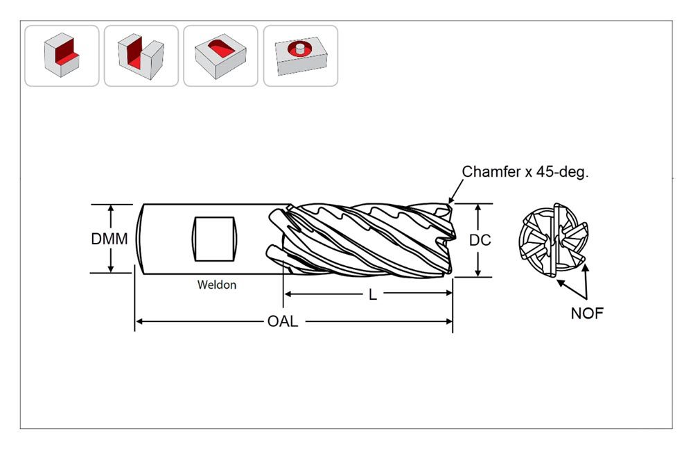

This SHTR 6-flute HSSCo8 (M42) cobalt roughing end mill has a 1.0 in \ 1" cutting diameter, with a 1" weldon shank, 4" length of cut (LOC), 0.03" chamfer, and a 6-1/2" overall length. It is hybrid AlCrN coated, and made to cut stainless steel and high temp. alloys. This roughing end mill is designed to center-cut.
ISO Material Chart
Haas Milling Series SHTR
Primary Workpiece Material S - High Temp Alloys, M - Stainless Steel
Material HSSCo8 (M42)
Coating Hybrid AlCrN
Corner Type Chamfer
Shank Type Weldon
[ØDC] Cutting Diameter 1.0 in \ 1"
[ØDMM] Shank Diameter 1.0 in
[LOC] Length Of Cut 4.0 in
[OAL] Overall Length 6.5 in
[NOF] Number of Flutes 6
[CHW\RE] Chamfer \ Radius Size 0.03 in
[FHA°] Helix Angle 35
Cutting Direction Right
Center Cutting Yes
Variable Pitch No
Through Spindle Coolant No
Weight 1.2 lbs \ 0.5 kg
