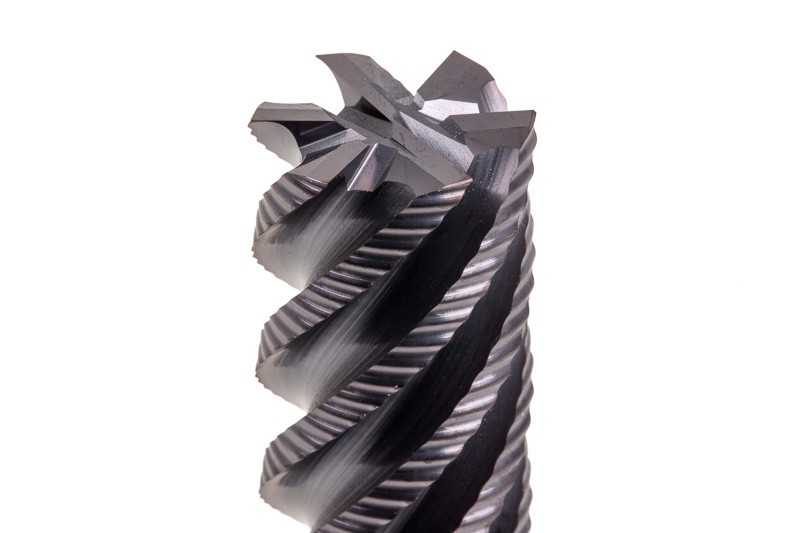

3/4" Dia. Carbide Fine Roughing End Mill, 6 Flute, TiAlN Coated, 3/4" Weldon Shank x 1-5/8" LOC, 0.007" Chamfer, FPCHH
Part #: 03-0673A
REM 3/4" HI HELIX 6FL CARB TIALN WF
Price: 157.95 ( / unit)
110.97
This FPCHH 6-flute carbide roughing end mill has a 0.75 in \ 3/4" cutting diameter, with a 3/4" weldon shank, 1-5/8" length of cut (LOC), 0.007" chamfer, and a 4" overall length. It is TiAlN coated, and made to cut steel, stainless steel, and high temp. alloys. This roughing end mill is designed to center-cut.
ISO Material Chart
Haas Milling Series FPCHH
Primary Workpiece Material M - Stainless Steel, P - Steel, S - High Temp Alloys
Material Carbide
Coating TiAlN
Corner Type Chamfer
Shank Type Weldon

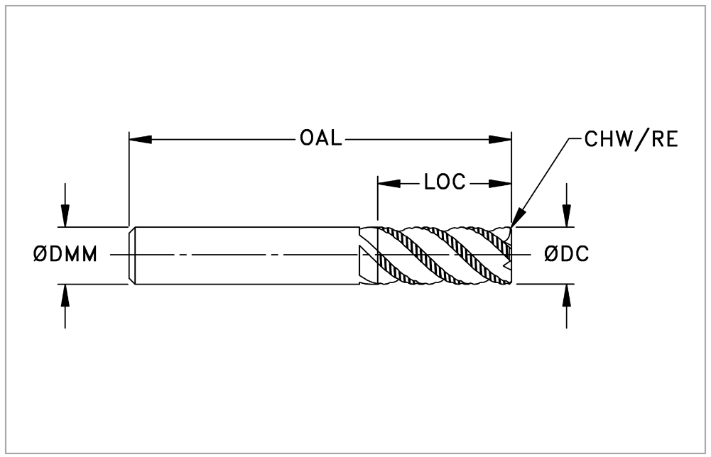

[ØDC] Cutting Diameter 0.75 in \ 3/4"
[ØDMM] Shank Diameter 0.75 in
[LOC] Length Of Cut 1.625 in
[OAL] Overall Length 4.0 in
[NOF] Number of Flutes 6
[CHW\RE] Chamfer \ Radius Size 0.007 in
[FHA°] Helix Angle 45
Cutting Direction Right
Center Cutting Yes
Variable Pitch No
Through Spindle Coolant No
Weight 0.8 lbs \ 0.4 kg
