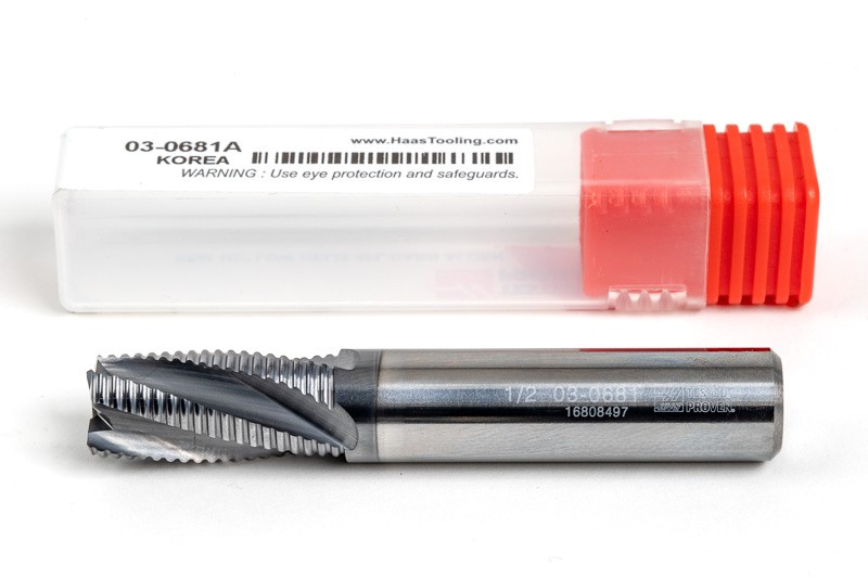

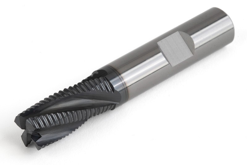

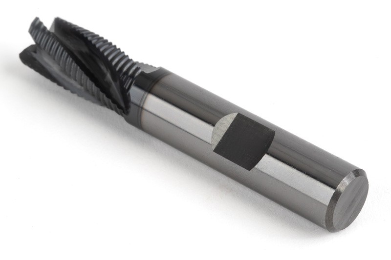

1/2" Dia. Carbide Fine Roughing End Mill, 4 Flute, Hybrid AlCrN Coated, 1/2" Weldon Shank x 1" LOC, 0.024" Chamfer, FPCLH
Part #: 03-0681A
REM 1/2" LOW HELIX 4 FL CARB ALCRN WF
Customer Rating:
Price: $62.95 ( / unit)
$50.97

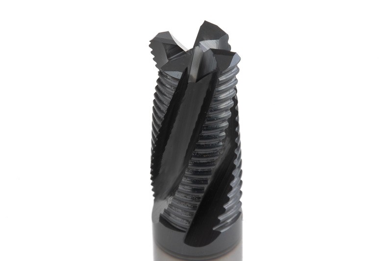

This FPCLH 4-flute carbide roughing end mill has a 0.5 in \ 1/2" cutting diameter, with a 1/2" weldon shank, 1" length of cut (LOC), 0.024" chamfer, and a 3" overall length. It is hybrid AlCrN coated, and made to cut steel and hardened metals. This roughing end mill is designed to center-cut.

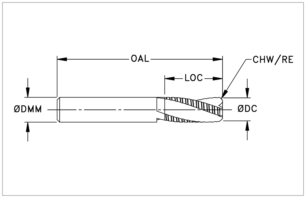

[ØDC] Cutting Diameter 0.5 in \ 1/2"
[ØDMM] Shank Diameter 0.5 in
[LOC] Length Of Cut 1.0 in
[OAL] Overall Length 3.0 in
[NOF] Number of Flutes 4
[CHW\RE] Chamfer \ Radius Size 0.024 in
