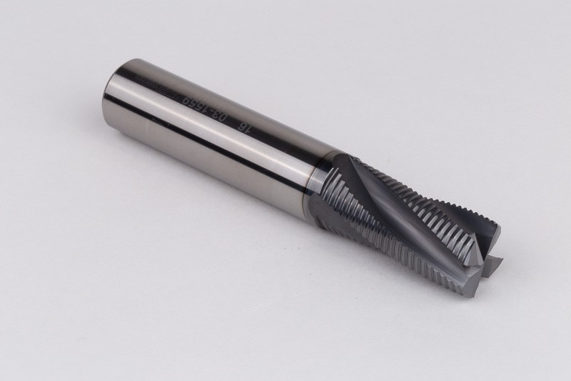

16mm Dia. Carbide Fine Roughing End Mill, 4 Flute, Hyb. AlCrN Coated, 16mm Smooth Shank x 32mm LOC, 0.6mm Chamfer, FPCLH
Part #: 03-1559
REM 16MM LOW HELIX 4FL CARB ALCRN
Price: 91.95 ( / unit)
Price: 1473.95 ( / unit)
Price: 438.95 ( / unit)
Price: 58.95 ( / unit)
Price: 265.95 ( / unit)
Price: 618.95 ( / unit)
87.97
This FPCLH 4-flute carbide roughing end mill has a 16mm cutting diameter, with a 16mm smooth shank, 32mm length of cut (LOC), 0.6mm chamfer, and a 92mm overall length. It is hybrid AlCrN coated, and made to cut steel and hardened metals, but is capable of cutting some grades of stainless steel and cast iron. This roughing end mill is designed to center-cut.
  • SPEEDS & FEEDS (SIDE CUTTING)
ISO Material Chart
Haas Milling Series FPCLH
Primary Workpiece Material P - Steel, H - Hardened Steels
Secondary Workpiece Material M - Stainless Steel, K - Cast Iron
Material Carbide
Coating Hybrid AlCrN
Corner Type Chamfer
Shank Type Smooth
[ØDC] Cutting Diameter 16.0 mm
[ØDMM] Shank Diameter 16.0 mm
[LOC] Length Of Cut 32.0 mm
[OAL] Overall Length 92.0 mm
[NOF] Number of Flutes 4
[CHW\RE] Chamfer \ Radius Size 0.6 mm
[FHA°] Helix Angle 20
Cutting Direction Right
Center Cutting Yes
Variable Pitch No
Through Spindle Coolant No
Weight 0.5 lbs \ 0.3 kg
