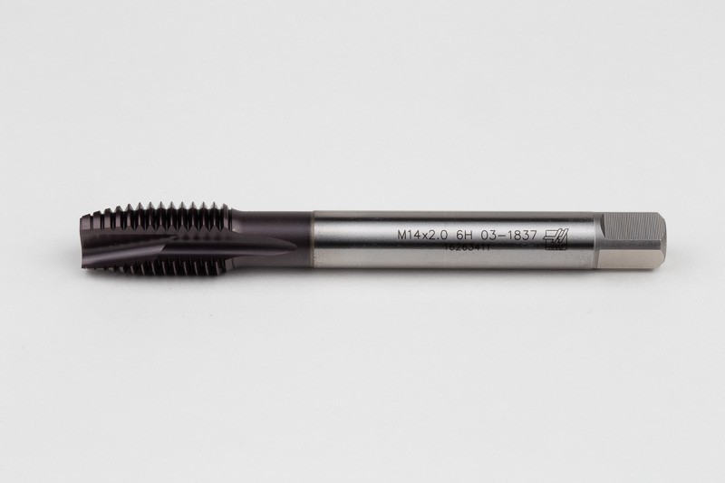

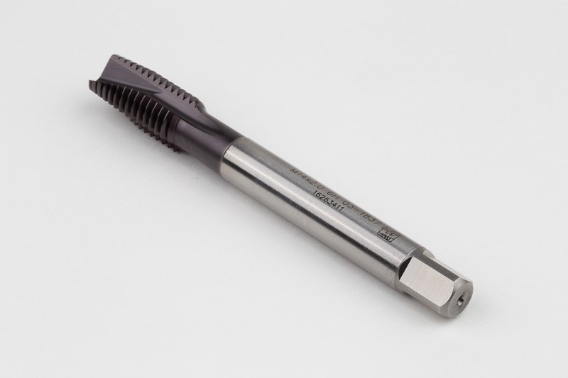

M14x2.0 M HSS-PM Spiral Point Tap, 11mm Shank x 26mm Thread Length, 3XD, Plug, 3 Flute, 6H, TiAlN Coated
Part #: 03-1837
M14 X 2 SP PT TI & NI ALLOY TAP
Price: $49.95 ( / unit)
Price: 673.95 ( / unit)
Price: 200.95 ( / unit)
Price: 26.95 ( / unit)
Price: 121.95 ( / unit)
Price: 282.95 ( / unit)
$39.97
  • SPEEDS & FEEDS (INCH)
  • SPEEDS & FEEDS (METRIC)
ISO MATERIAL CHART
Thread Series M - Metric
Thread Size M14x2.0
Primary Workpiece Material P - Steel, S - High Temp Alloys
Secondary Workpiece Material H - Hardened Materials
Tap Type Spiral Point
Chamfer Type Plug
Shank Type Square
Material HSS-PM
Coating TiAlN
[TP] Thread Pitch 2.0 mm
Tap Drill Diameter 12.0 mm
[ØDC] Cutting Diameter 14.0 mm
[ØDMM] Shank Diameter 11.0 mm
[L2] Chamfer Length 4P - 5P
[L1] Thread Length 26.0 mm
[LU] Usable Length 44.0 mm
[OAL] Overall Length 110.0 mm
[SS] Square Size 9.0 mm
[NOF] Number of Flutes 3
[FHA°] Helix Angle 0
Length / Diameter 3 X D
Thread Class 6H
Through Spindle Coolant No
Weight 0.2 lbs \ 0.1 kg
