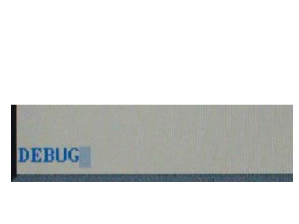

With setting 7 turned off, enter Debug mode by going to the alarms page. Type “DEBUG” and press Enter. Zero-return the V-axis, by pressing “ZERO RET”, entering “V”, followed by “SINGL AXIS”.

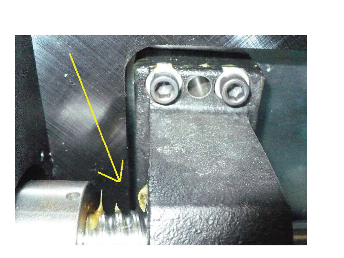

Jog the V-axis toward the lathe, until there is 0.050” clearance between the trolley and the bearing support for the ball screw (or end plate, whichever is closer. Do not jog closer than 0.050" to any component.) Press the ‘Posit’ key and record the encoder counts.
