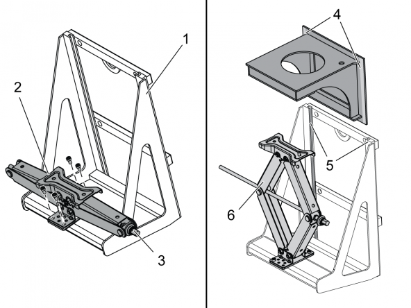

Put the lower frame [1] on the floor.
Attach the jack [2] to the lower frame with (4) screws. Align the jack so that the operation screw [3] faces to the right. Do not tighten the screws at this time.
Turn the jack operation screw [3]. Fully extend the jack [6].
Apply grease to both sides [4] of the upper frame.
Put the upper frame into the slots [5] on the lower frame. Move the upper frame down until it touches the top of the jack.
Attach the upper plate of the jack to the upper frame [1] with (2) screws. Do not tighten the screws at this time.
Visually align the front edge of the jack lower plate with the front edge of the lower frame [2]. Tighten the (4) lower screws. Visually align the jack with the front edge of the upper frame. Tighten the (2) upper screws.

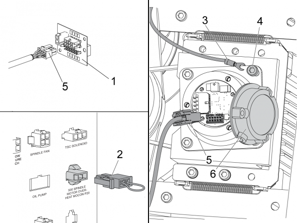

Connect a jumper (P/N 33-0819A) [2] to the connector with the label 500 SPINDLE MOTOR OVERHEAT MOCON P20 on the spindle connector-panel.
Remove the encoder cover [6].
Disconnect the encoder cable [5] from the terminal. Disconnect the ground cable [3].
Pull the encoder cable out of the spindle shroud and casting.
Connect the encoder cable [5] to the T-2200 [1]
Lightly tighten the ground cable screw [4].
Replace the encoder cover [6].

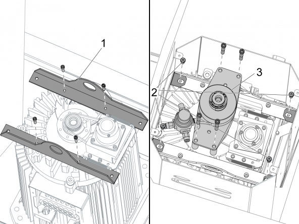

Remove the (4) motor-shroud screws [1] from the motor lift brackets. Do not remove the brackets.

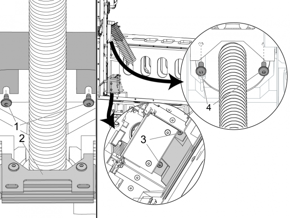

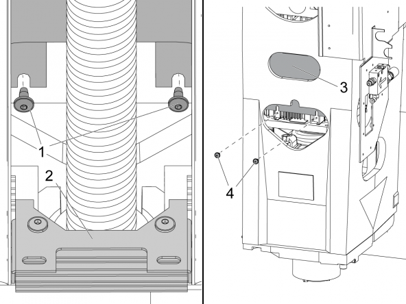

Remove the (2) bottom screws [2] from the front of the Y-Axis top cover. This releases the bottom of the Z-Axis bellows.
Tilt the Z-Axis bellows [1] towards the rear of the machine.
Remove the (2) screws [2] from the top cover for the Z-Axis bellows.
Push the Z-Axis bellows [2] down until you can reach the screws [1] for the motor shroud. Remove the screws.

Remove the (2) lower screws [4] from the spindle junction box.
Slide the junction box cover [3] up to expose the (2) front motor shroud screws.
6
Remove the (2) front of the motor shroud screws [1].
Remove the motor shroud [2].
Remove the (2) motor lift-brackets.

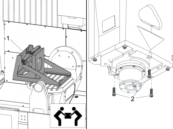

Put the spindle removal tool (SRT) [1] onto the platter.
Align the SRT parallel with the table slots, to make the jack screw face you.
 Caution: The SRT is heavy. Do not lift it into the UMC without the aid of another person.
Attach the SRT to the table with (4) T-slot screws [4].
Tighten the screws.
Turn each screw 1/4 turn in the counter-clockwise direction.

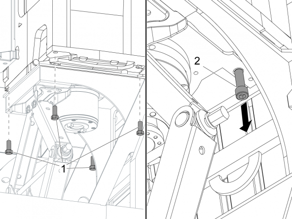

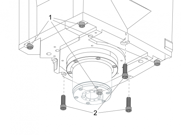

Remove the (3) center screws [2] for the spindle motor assembly.
Loosen the (4) remaining spindle motor assembly screws [1].
Caution: Do not remove the (4) screws [1].
10
Release the EMERGENCY STOP.
Slowly jog Z Axis in the negative (-) direction until the spindle touches the SRT frame.
Press EMERGENCY STOP.
Record the X, Y, and Z Axis positions. Use these during the installation procedure.

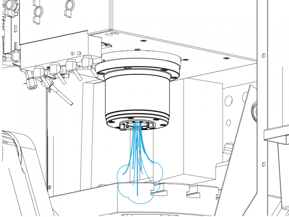

Disconnect the spindle-motor cables from the terminal block.
Pull the motor wires [1] out of the casting.
Wrap the smaller wires [2] into a coil below the junction box.
Put wire nuts on the motor wires.
Remove the (4) remaining screws [3] for the spindle motor assembly.
12
Slowly turn the jack screw [1] to lower the spindle motor assembly out of the head casting.
Turn the actuating screw until the jack is at the bottom of its travel.

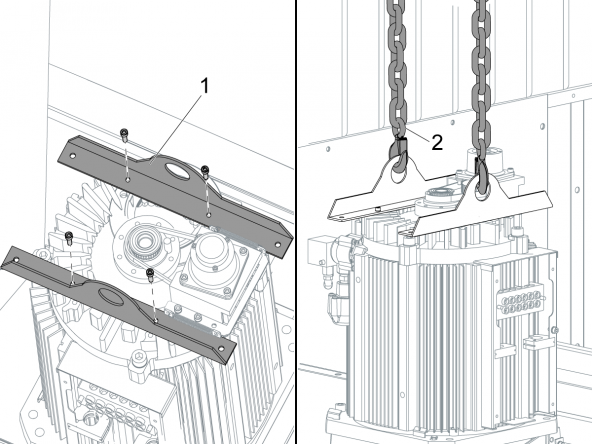

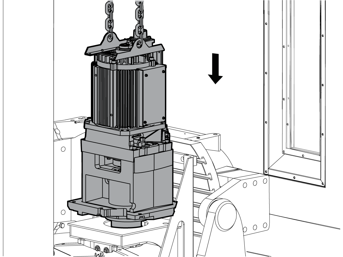

Attach the lift plates [1] to the top of the spindle motor.
Attach the chains [2] from a hoist to the lift plates.
Caution: The spindle motor assembly weighs a minimum of 112 lb (55 kg). Make sure to use a hoist that is sufficient for the weight of the spindle motor assembly.
Remove the SRT anchor-screw from the spindle motor through the SRT frame.
Lift the spindle motor assembly from the machine.

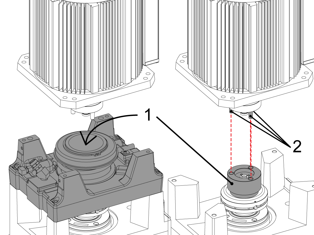

  • Press EMERGENCY STOP.
  • Turn the jack actuating screw to raise the top SRT frame until it is even with the top of the table (See Step 8 of the "Removal" section above).
  • Use a hoist to position the spindle motor assembly centered over the TRP.
  •  Caution: The spindle motor assembly weighs more than 112 lb (55 kg). Use a hoist that is sufficient for the weight of the spindle motor assembly. Do not attempt to install the motor by hand.
  • When lowering the motor onto the rest of the spindle assembly, be sure to align the 3 pins of the male side of the coupler [2] to the respective holes of the female side of the coupler [1] that can be seen below the TRP sub assembly. Rotate the male side by hand to adjust alignment.
  •  Warning: Damage will occur if the coupler is not aligned properly.
  • Do not remove or adjust the TRP.
