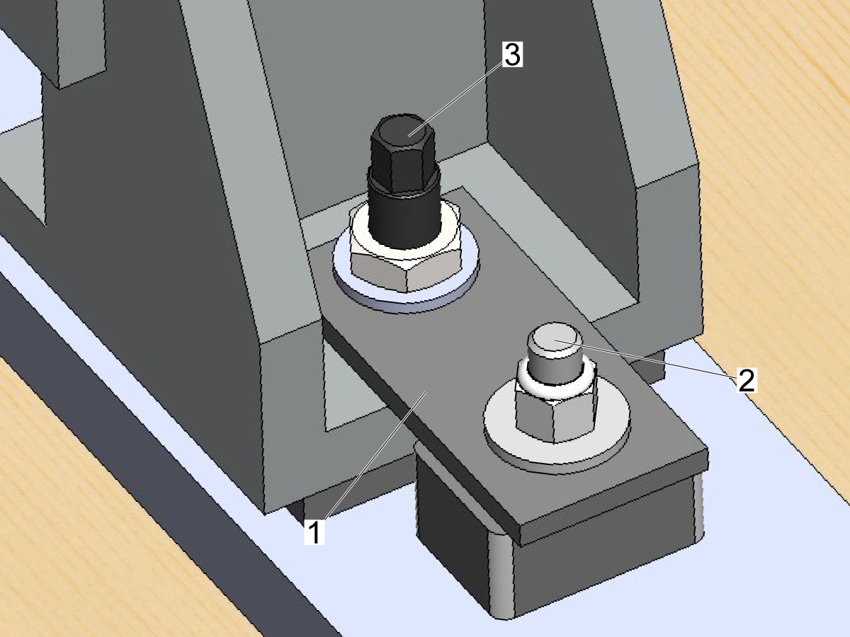

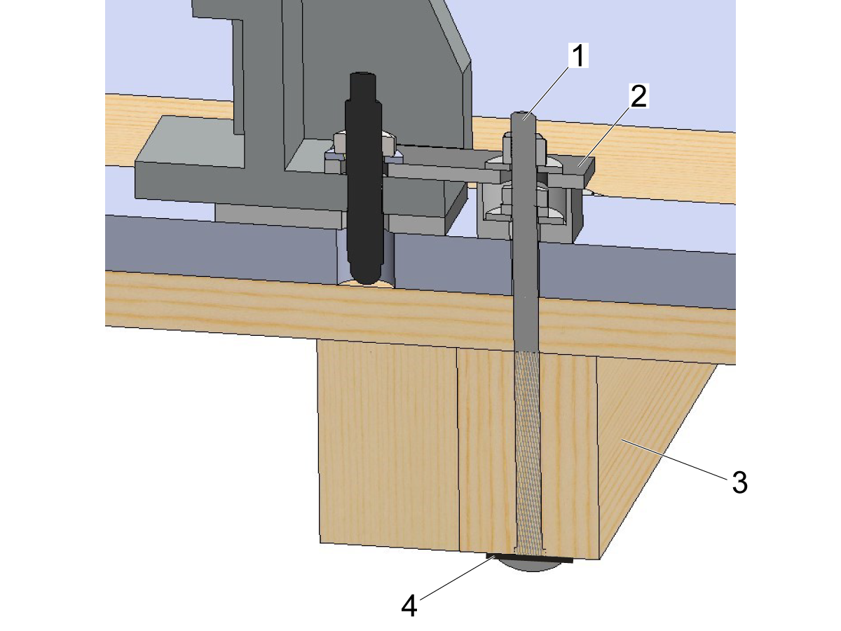

The machine mounts to the shipping skid by a steel plate[1] and a carriage bolt[2]. The other end of the plate connects to the base of the machine by the leveling screw[3].
Shipping Skid Hardware
  1. Carriage Bolt 3/4" (20mm)
  2. Steel Plate 3/8" x 3" (10mm x 75mm)
  3. 4x4 (100mm x 100mm) Timber
  4. Steel Plate
