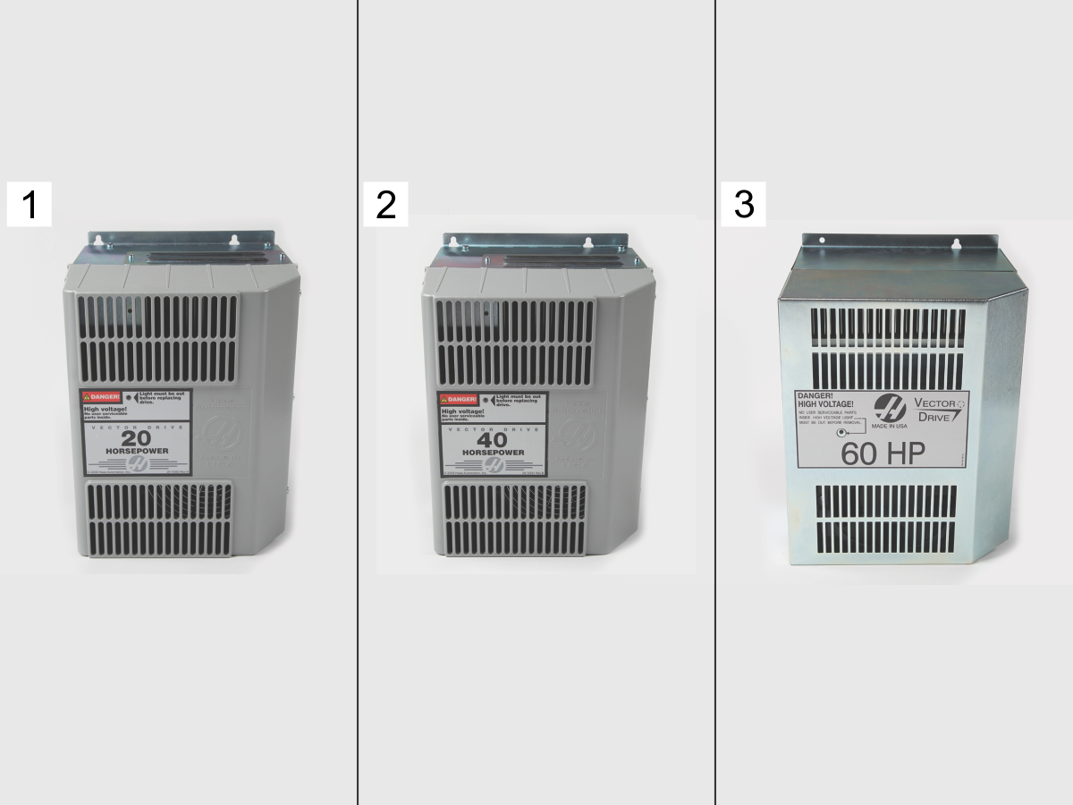

The Haas Vector drive is the source of power for the spindle motor and the servo amplifiers. There are three sizes of Haas Vector drives: 20HP [1], 40HP [2] and 60HP [3].

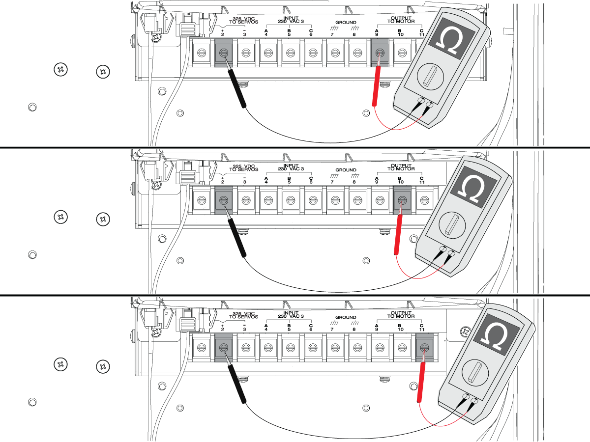

Set your meter to Ohms test mode.
  • Put the black lead on terminal 2 (+) with the red lead measure the motor output terminals 9 (A), 10 (B) and 11 (C).
The meter should show high resistance readings typically in the Kilo or Mega ohms or O.L.  If the meter reads very low resistance the Vector drive is damaged.
Note: If the meter shows O.L this indicates an open circuit and there is no short between the terminals.
  • Put the black lead on terminal 3 (-) with the red lead measure the motor output terminals 9 (A), 10 (B) and 11 (C).
The meter should show high resistance readings typically in the Kilo or Mega ohms or O.L.  If the meter reads very low resistance the Vector Drive is damaged.
Note: If the meter how O.L this indicates an open circuit and there is no short between the terminals.

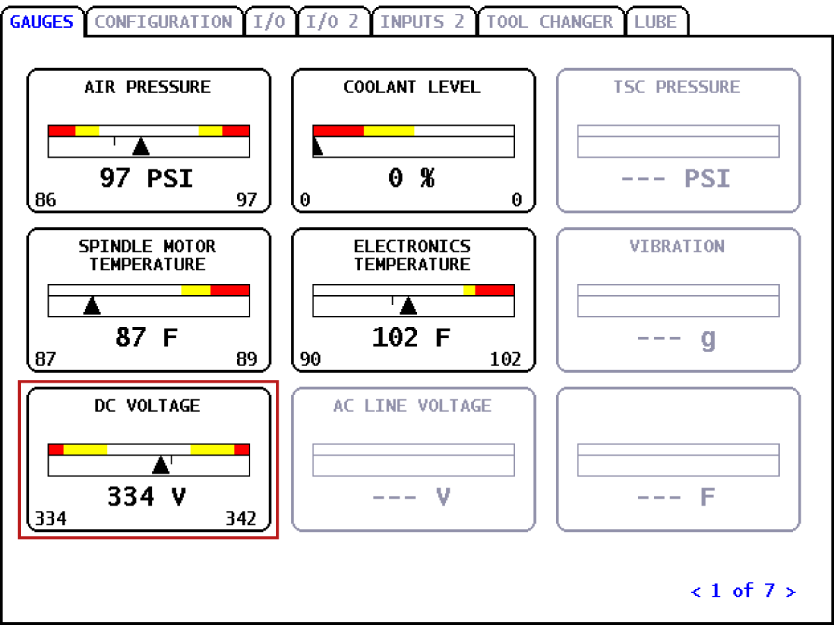

Press [POWER ON]. Measure the DC voltage between terminals 2 and 3 on the vector drive. Compare the measured voltage with the DC VOLTAGE on the diagnostics page on the control. The readings must match +-2%.
If the readings do not match, the problem can be:
  • A bad connection on the 640C cable. Make sure there is a tight connection on the J3 connector on the Vector Drive and the P17 connector on the Maincon/Mocon.
  • A faulty Vector Drive if you have incorrect voltage at P17.
  • A faulty Maincon/Mocon if you have the correct voltage on the 640C cable at the P17 connector of the Maincon/Mocon. There is 0.01 VDC for every 1 VDC Bus. For example, 320 VDC must show 3.2VDC.

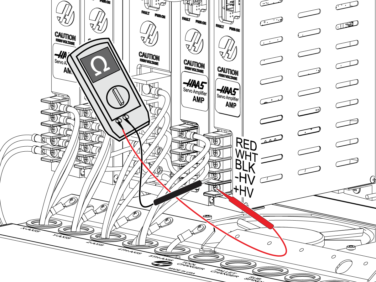

  • If the DC Bus goes back to the nominal value, there is a short in one of the servo amplifiers. A low resistance or a short is a sign of a faulty servo amplifier.

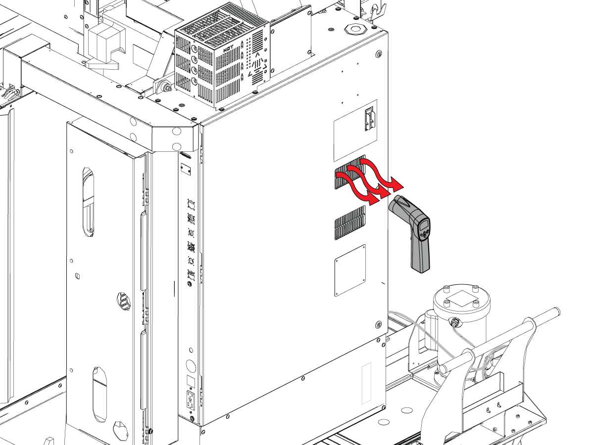

An over-temperature alarm is generated when the vector drive's heat-sink reaches 90°C. The cooling fan must turn ON when the heat-sink temperature reaches 50°C. The cooling fan must turn OFF as the heat-sink cools down.
Measure the temperature of the vector drive's heat-sink through the exhaust vents when this alarm occurs. If the temperature is above 60°C and the fan is not ON, the vector drive has a faulty cooling fan. Replace the cooling fan.

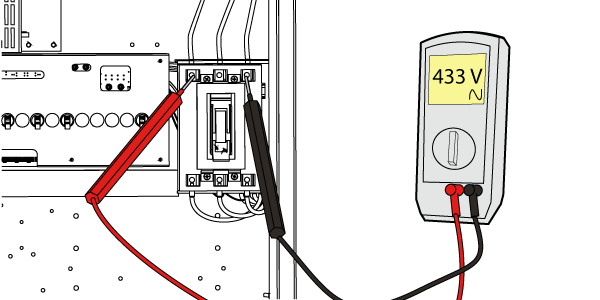

Incoming AC Voltage
Corrective Action:
Measure the incoming voltage to the machine. Make sure that the incoming voltage is within the range of the transformer’s tap. Move the lines to the correct tap if needed.

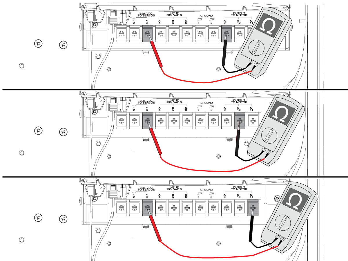

Corrective Action: Disconnect the motor cables at the vector drive. Push [POWER ON]. Push [RESET] to clear any alarms. Use a multimeter to measure the DC voltage across the following terminals on the vector drive (see the illustration):
  • 3 and 9
  • 3 and 10
  • 3 and 11
The voltage measured must be approximately half of the DC Buss in all three readings.
IMPORTANT: If any of the voltage readings is 0V or 330V, then this is a sign of an unbalanced output from the vector drive.  DO NOT REPLACE THE VECTOR DRIVE IF THE ABOVE CONDITIONS ARE NOT MET.
