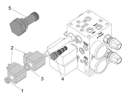

Under certain conditions when using a low tailstock pressure setting, the hydraulic tailstock can get stuck at home position.
Replacing the dual piloted check valve with the check valve eliminator will eliminate this issue.
Lathe - Hydraulic Tailstock Check Valve Eliminator - Installation
