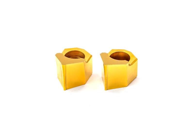

HIN-HTD3, 10 - 24 Teeth HTD® Synchronous Pulley Insert, 16 Tooth Profile, 3mm Pitch, Size 10, TiN Coated - Pack of 2
Part #: 02-1214
HIN-HTD3-10/24
Price: $104.95 ( / unit)
Price: 2623.95 ( / unit)
Price: 780.95 ( / unit)
Price: 104.95 ( / unit)
Price: 472.95 ( / unit)
Price: 1101.95 ( / unit)
  • Technical Details
  • Speeds and Feeds
Insert Style Pulley
Insert Profile 16 Tooth
Insert Size 10
Belt Type PowerGrip®, HTD® Synchronous
Part Diameter Range (Inch) 0.346 - 0.872 in (HTD3-10/24)
Part Diameter Range (Metric) 8.79 - 22.16 mm (HTD3-10/24)
Teeth Range (Min. - Max.) 10 - 24 (3mm Pitch)
Primary Workpiece Material N - Aluminum, K - Cast Iron, P - Steel
Secondary Workpiece Material S - High Temp Alloys, M - Stainless Steel, H - Hardened Materials
Chamfer Yes
Pitch 3
[INSL] Insert Length 0.728 in \ 18.5 mm
[W1] Insert Width 0.515 in \ 13.1 mm
[h] Insert Height 0.551 in \ 14.0 mm
[Ap] Max. Cutting Depth 0.048 in \ 1.22 mm
[S] Insert Thickness 0.394 in \ 10.0 mm
Country of Origin Italy
