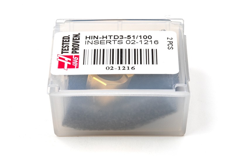

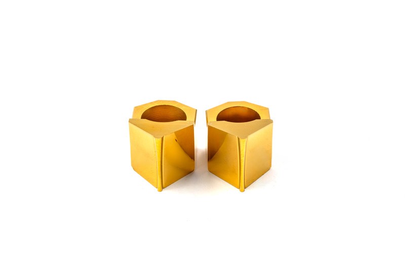

HIN-HTD3, 51 - 100 Teeth HTD® Synchronous Pulley Insert, 74 Tooth Profile, 3mm Pitch, Size 10, TiN Coated - Pack of 2
Part #: 02-1216
HIN-HTD3-51/100
Price: 104.95 ( / unit)
Price: 2623.95 ( / unit)
Price: 780.95 ( / unit)
Price: 472.95 ( / unit)
Price: 1101.95 ( / unit)
  • Technical Details
  • Speeds and Feeds
Insert Style Pulley
Insert Profile 74 Tooth
Insert Size 10
Belt Type PowerGrip®, HTD® Synchronous
Part Diameter Range (Inch) 1.887 - 3.73 in (HTD3-51/100)
Part Diameter Range (Metric) 47.94 - 94.73 mm (HTD3-51/100)
Teeth Range (Min. - Max.) 51 - 100 (3mm Pitch)
Primary Workpiece Material P - Steel, K - Cast Iron, N - Aluminum
Secondary Workpiece Material M - Stainless Steel, H - Hardened Materials, S - High Temp Alloys
Chamfer Yes
Pitch 3
[INSL] Insert Length 0.728 in \ 18.5 mm
[W1] Insert Width 0.515 in \ 13.1 mm
[h] Insert Height 0.551 in \ 14.0 mm
[Ap] Max. Cutting Depth 0.048 in \ 1.22 mm
[S] Insert Thickness 0.394 in \ 10.0 mm
Country of Origin Italy
