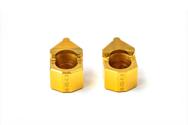

HIN-HTD5, 47 - 90 Teeth HTD® Synchronous Pulley Insert, 68 Tooth Profile, 5mm Pitch, Size 10, TiN Coated - Pack of 2
Part #: 02-1219
HIN-HTD5-47/90
Price: $104.95 ( / unit)
Price: 2623.95 ( / unit)
Price: 780.95 ( / unit)
Price: 104.95 ( / unit)
Price: 472.95 ( / unit)
Price: 1101.95 ( / unit)
  • Technical Details
  • Speeds and Feeds
Insert Style Pulley
Insert Profile 68 Tooth
Insert Size 10
Belt Type PowerGrip®, HTD® Synchronous
Part Diameter Range (Inch) 2.900 - 5.594 in (HTD5-47/90)
Part Diameter Range (Metric) 73.66 - 142.10 mm (HTD5-47/90)
Teeth Range (Min. - Max.) 47 - 90 (5mm Pitch)
Primary Workpiece Material P - Steel, N - Aluminum, K - Cast Iron
Secondary Workpiece Material H - Hardened Materials, M - Stainless Steel, S - High Temp Alloys
Chamfer Yes
Pitch 5
[INSL] Insert Length 0.728 in \ 18.5 mm
[W1] Insert Width 0.515 in \ 13.1 mm
[h] Insert Height 0.551 in \ 14.0 mm
[Ap] Max. Cutting Depth 0.082 in \ 2.08 mm
[S] Insert Thickness 0.394 in \ 10.0 mm
Country of Origin Italy
