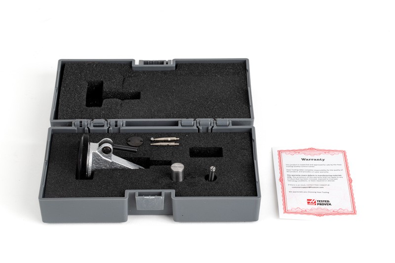

Vertical Dial Test Indicator, 0.0005" Graduation, 0.06" Twice-Range, 0-15-0 Dial, Large Face
Part #: 09-0097
DIAL TEST INDICATOR, .0005", 0-.06", VXL
Price: 101.95 ( / unit)
76.97

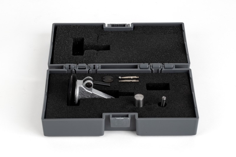

This Haas vertical dial test indicator has graduations of 0.0005" with 0-15-0 dial numbering and a range of 0.06". Vertical style test indicators have the dial at the top of the body, so it can be read from above - ideal for situations like finding centerlines on milling machines, where a horizontal style would rotate out of view. A built-in stem and two accessory stems allow for versatile mounting options. Comes with 3 different stylus tip diameters. Jeweled bearings ensure smooth movement and longer service life compared to plain bearings. Made according to DIN2270.
  • Operator's Manual
Type Dial Test Indicator
Graduation 0.0005 in
Indicator Type Vertical
Gauge Type Dial
Mount Type Stem, Dovetail
Range 0 - 0.06 in
Range Per Revolution 0.03 in
Dial Reading 0-15-0
Dial Diameter 1.5 in
Dial Type Balanced
Stylus Tip Material Carbide
Stylus Tip Diameter 0.039 in, 0.079 in, 0.118 in
Stylus Length 0.686 in
Stylus Thread M1.6-0.35
Bearing Type Jeweled
Stem Diameter 5/32"
Accessory Stem Diameter 5/32", 3/8"
Accuracy ± 0.0005 in
Standard DIN2270
Conformance Standard CNAS
Weight 0.6 lbs \ 0.3 kg
