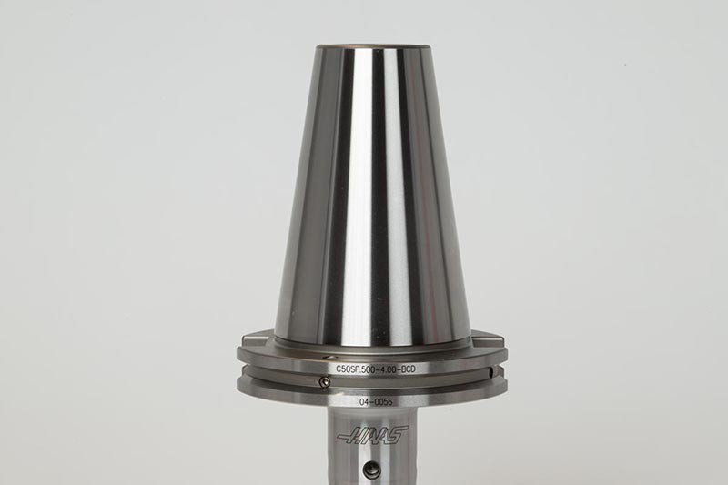

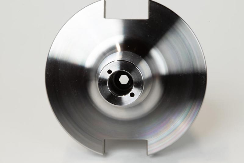

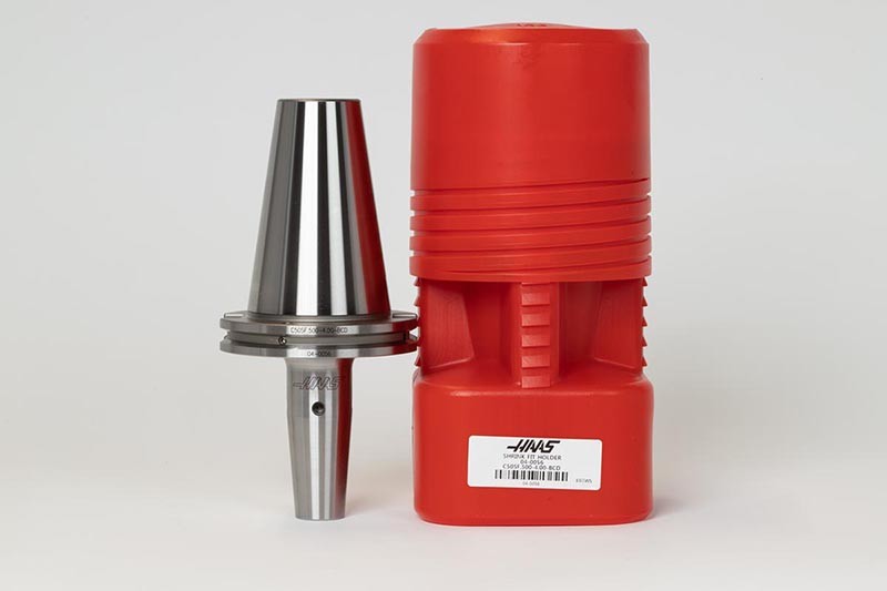

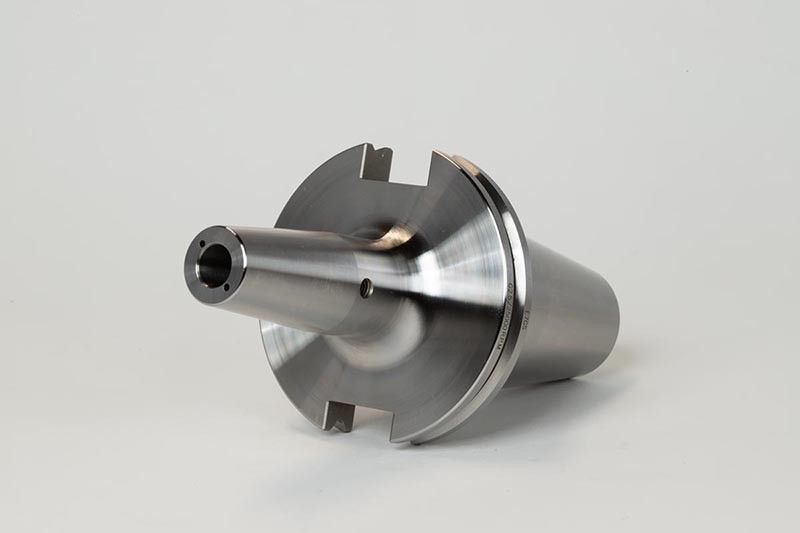

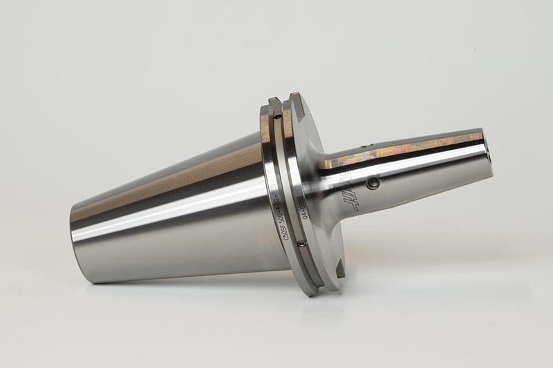

CT50 1/2" Shrink Fit Holder x 4" Gage Length, TSC
Part #: 04-0056
C50SF.500-4.00-BCD
Price: $304.95 ( / unit)
$243.97
This CAT50 shrink fit holder has a 0.5 in \ 1/2" bore diameter, and a 4" gage length. It offers very low runout (0.0001" TIR), very high grip force, and quick tool changeovers when used in conjuction with Haas shrink fit machines. It is through-tool coolant (TSC) capable, with a 1"-8 pull stud/retention knob thread.
$231.77 (Save 5%)
Taper CT50

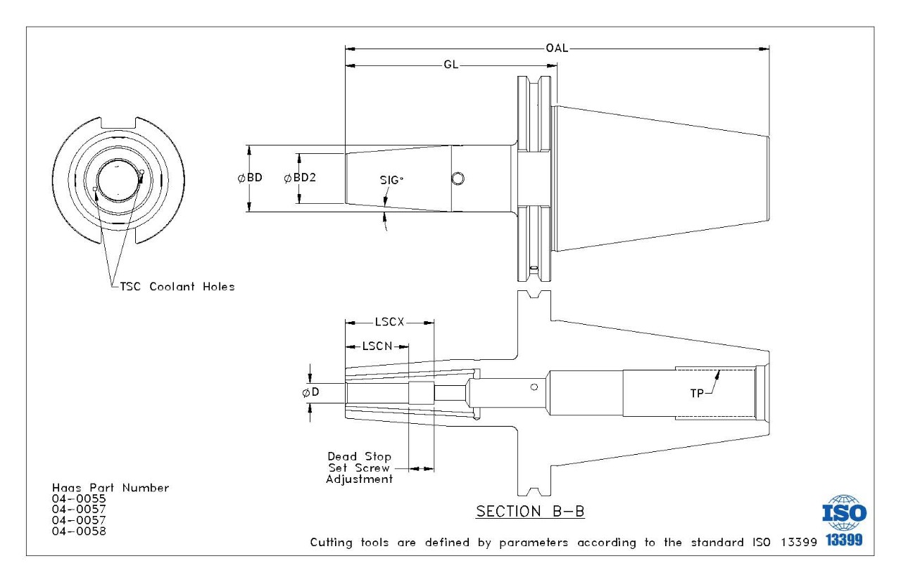

[ØD] Bore Diameter 0.5 in \ 1/2"
[ØBD2] Minimum Body Diameter 0.945 in
[ØBD] Maximum Body Diameter 1.26 in
[GL] Gage Length 4.0 in
[OAL] Overall Length 8.0 in
[LSCN] Minimum Clamping Length 1.496 in
[LSCX] Maximum Clamping Length 1.929 in
[SIG°] Angle 4.5 °
Concentricity 0.00012 in
Balanced to RPM 25,000
Retention Knob Thread Size 1"-8
Through Tool Coolant Yes
Spindle Drive Slots Yes
Weight 6.7 lbs \ 3.1 kg
