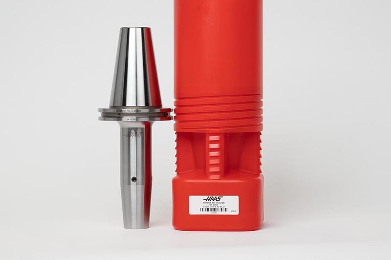

CT50 3/4" Shrink Fit Holder x 6.3" Gage Length, TSC
Part #: 04-0064
C50SF.750-6.30-BCD
Price: $325.95 ( / unit)
$277.97
This CAT50 shrink fit holder has a 0.75 in \ 3/4" bore diameter, and a 6.299" gage length. It offers very low runout (0.0001" TIR), very high grip force, and quick tool changeovers when used in conjuction with Haas shrink fit machines. It is through-tool coolant (TSC) capable, with a 1"-8 pull stud/retention knob thread.
$264.07 (Save 5%)

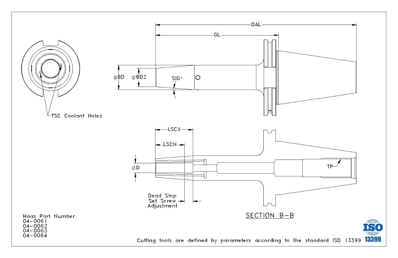

Taper CT50
[ØD] Bore Diameter 0.75 in \ 3/4"
[ØBD2] Minimum Body Diameter 1.299 in
[ØBD] Maximum Body Diameter 1.654 in
[GL] Gage Length 6.299 in
[OAL] Overall Length 10.299 in
[LSCN] Minimum Clamping Length 1.654 in
[LSCX] Maximum Clamping Length 2.126 in
[SIG°] Angle 4.5 °
Concentricity 0.00012 in
Balanced to RPM 25,000
Retention Knob Thread Size 1"-8
Through Tool Coolant Yes
Spindle Drive Slots Yes
Weight 8.5 lbs \ 3.9 kg
