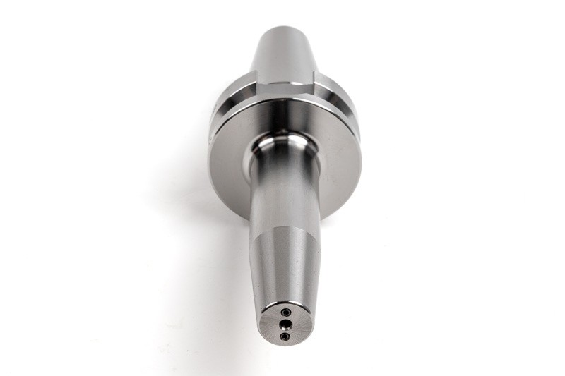

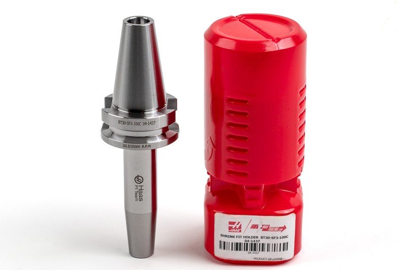

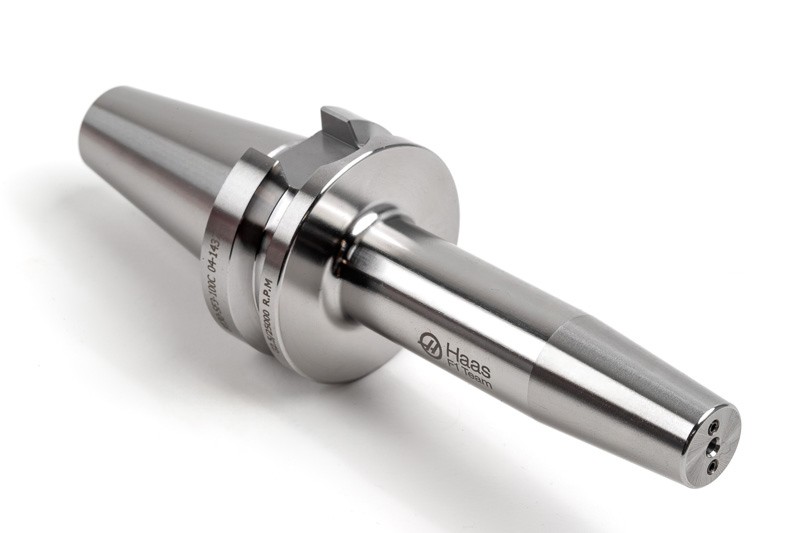

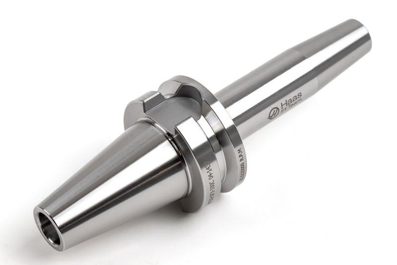

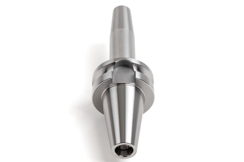

This BT30 shrink fit holder has a 3mm bore diameter, and a 100mm gage length. It offers very low runout (0.003mm TIR), very high grip force, and quick tool changeovers when used in conjuction with Haas shrink fit machines. It is through-tool coolant (TSC) capable, with a M12x1.75 pull stud/retention knob thread.
Taper BT30
[ØD] Bore Diameter 3.0 mm
[ØBD2] Minimum Body Diameter 15.0 mm
[ØBD] Maximum Body Diameter 20.0 mm
[GL] Gage Length 100.0 mm
[OAL] Overall Length 148.4 mm
[LSCN] Minimum Clamping Length 15.0 mm
[SIG°] Angle 4.5 °
Concentricity 0.003 mm
Balanced to RPM 25000
Retention Knob Thread Size M12X1.75
Through Tool Coolant Yes
Spindle Drive Slots Yes
Weight 1.3 lbs \ 0.6 kg
