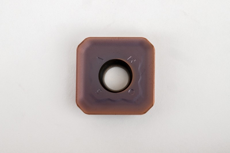

HSPP - High-Speed Face Milling Insert
✓ Designed for high-speed facing operations
✓ Single-sided insert with 4 cutting edges
✓ Large rake angle for faster and easier cutting
Insert Style
HSPP
HAAS SQUARE POSITIVE POSITIVE
TOOLPATH TYPE
FACE MILLING
45° cutting edge | D.O.C. max .236" (5.99mm)
• Positive axial rake, positive radial rake
• Large rake angle for faster, easier cutting
• Inserts with 4 cutting edges
Insert Grade
HMP20
APPLICABLE WORKPIECE MATERIALS
○ P - STEEL
●  M - STAINLESS STEEL
Primary grade for stainless steel. Secondary grade for steel. PVD multilayer-coated carbide substrate for finishing to medium applications in stainless steel, super alloys, and steel. Optimized coating stability for higher wear resistance and thermal stability in a wide range of applications.
●  Primary Workpiece Material | ○  Secondary Workpiece Material
TOOLPATH LEGEND
FACE MILLING
SHOULDER MILLING
SLOTTING
RAMPING
HELICAL MILLING
COPY MILLING
PLUNGE MILLING
CHAMFER MILLING
ISO MATERIAL CHART
Insert Style Square
Toolpath Type Face Milling
Milling Cutter Series HSPP - Haas Square + / +
Primary Workpiece Material M - Stainless Steel
Secondary Workpiece Material P - Steel
Grade HMP20
Material Carbide
[IC] Inscribed Circle Diameter 0.528 in \ 13.4 mm
[INSL] Insert Length 0.528 in \ 13.4 mm
[D1] Insert Hole Size 0.161 in \ 4.1 mm
[S] Insert Thickness 0.156 in \ 3.97 mm
[Ap] Max. Cutting Depth 0.236 in \ 6.0 mm
Wiper Edge Length 0.1 in \ 2.55 mm
[AN°] Clearance Angle 20
