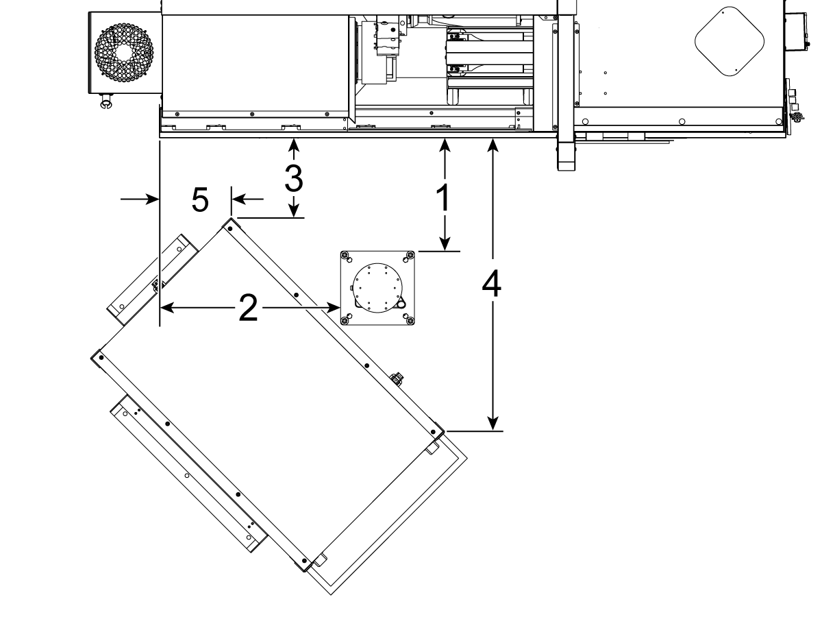

Measure these dimensions from the machine's skirt to the pedestal's side.
 Note: The following dimensions are recommended distances. The position may vary depending on the users application.
Use the dimensions in the next steps as a reference for front and side loading cobots.
The Haas Cobot 10 is recommended to be paired with the Haas Cobot pedestal. This pedestal is configured to be sufficiently stable when used according to Haas defined part size and weight limits.
Front Loading:
Position the pedestal and parts table in the following location relative to the machine:
Dimension Imperial (Inches) Metric (cm)
Front of machine to front side of pedestal [1] 5.5 in. 14 cm.
Left of machine to left side of pedestal [2] 29.5 in. 75 cm.
Front of machine to front side of parts table [3] 22 in. 56 cm.
Left of machine to left side of parts table [4] 10 in. 25.4 cm.
Side Loading:
Front of machine to left side of pedestal [1] 20.5 in. 52 cm.
Right of machine to front side of pedestal [2] 8.5 in. 21.6 cm.
Front of machine to left side of parts table [3] 1.5 in. 3.8 cm.
Right of machine to front side of parts table [4] 21.5 in. 54.6 cm.
Anchor the pedestal into the ground. Level the pedestal using a bubble level.
 NOTE: For the adjustable pedestal, set the desired height by loosening the set screws [1] then adjusting the clevis pin [2]. Retighten the set screws [1] before installing the robot. Place a bubble level on the top of the pedestal while using the (x4) hex bolts at the base to set the level in the X & Y plane.
Place the Cobot control box [3] directly next to the pedestal to ensure enough slack for the cables.

ST-20 and ST-25 Machines & DS-20Y/25Y:
Front of machine to front side of pedestal [1] 19.5 in 49.5 cm
Left of machine to left side of pedestal [2] 28.5 in 72.4 cm
Front of machine to front left corner of parts table [3] 14.5 in 36.8 cm
Front of machine to front right corner of parts table [4] 71 in 180 cm
Left of machine to front left corner of parts table [5] 10.75 in 27.3 cm
 Note: The following dimensions are recommended distances. The position may vary depending on the users application. Refer to the next steps for the positioning on the cobot and parts table for either front loading or side loading cobots.
Front Loading:
Front of machine to front side of pedestal [1] 13 in. 33 cm.
Left of machine to left side of pedestal [2] 24 in. 61 cm.
Front of machine to front left corner of parts table [3] 8 in. 20.3 cm.
Front of machine to front right corner of parts table [4] 42.25 in. 107 cm.
Left of machine to front left corner of parts table [5] 6.25 in. 15.9 cm.
Side Loading:
Front of machine to left side of pedestal [1] 21 in. 53.4 cm.
Right of machine to font side of pedestal [2] 13 in. 33 cm.
Front of machine to left side of parts table [3] 3 in. 7.6 cm.
Right of machine to front side of parts table [4] 27 in. 68.6 cm.
Set the desired height by loosening the set screws [1] then adjusting the clevis pin [2]. Retighten the set screws [1] before installing the robot. Place a bubble level on the top of the pedestal while using the (x4) hex bolts at the base to set the level in the X & Y plane.
Note: The layouts in the previous steps have a pedestal height of 24 inches (61 cm).

Front Loading:
Front of machine to front side of pedestal [1] 9.5 in. 24 cm.
Left of machine to left side of pedestal [2] 38 in. 96.5 cm.
Front of machine to front left corner of parts table [3] 4.5 in. 11.5 cm.
Front of machine to back left corner of parts table [4] 27 in. 68.5 cm.
Left of machine to front left corner of parts table [5] 21 in. 53 cm.
