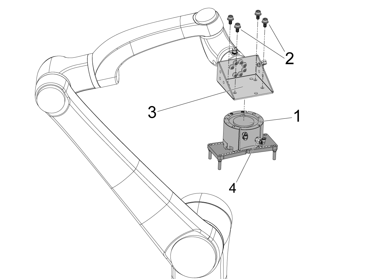

Remove the Cobot from the shipping box.
 NOTE: Install the adapter plate between the pedestal and robot if needed.
Install the Cobot on top of the pedestal with (x6) screws.
NOTE: Make sure the cobot cable connector [1] is perpendicular with the front of the machine.
IMPORTANT: The Cobot is about 45 lbs and should be lifted with a device that can safely lift that weight.

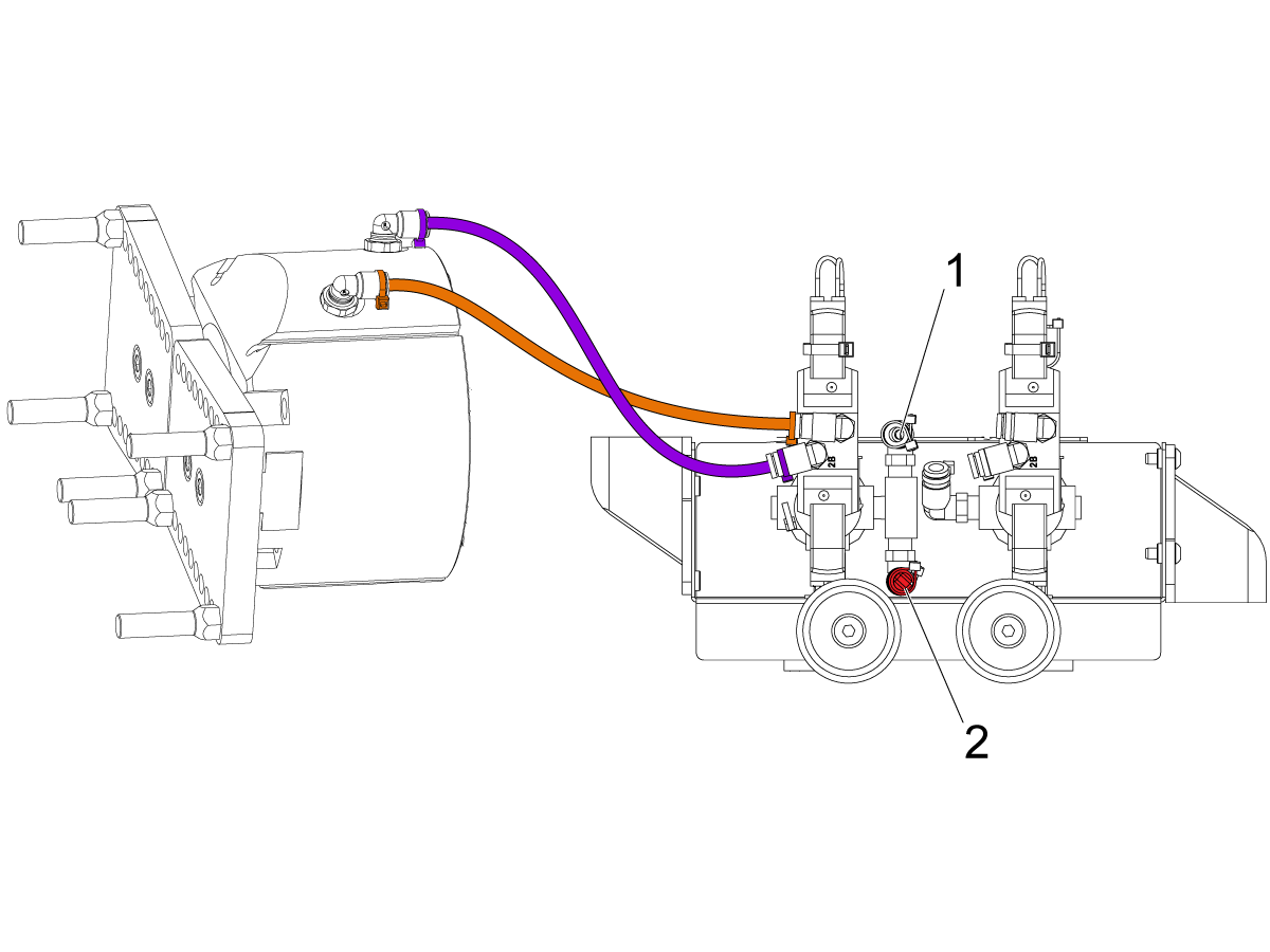

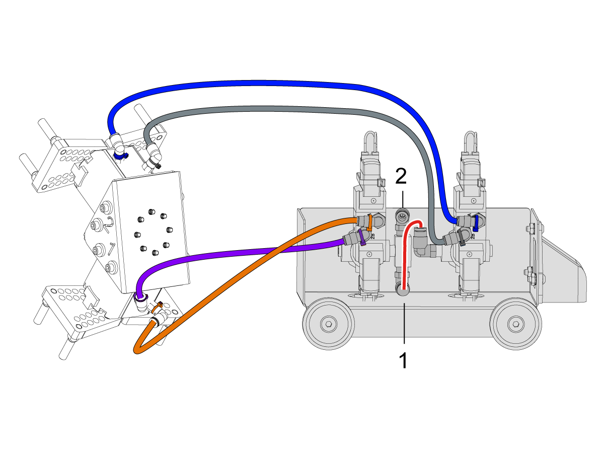

Steps 7 thru 10 are wiring and hose routing instructions for the pneumatic grippers. Refer to the grippers installation section lower on this page for the mechanical installation.
Install the dual air solenoid assembly on to the side of the pedestal while giving the airlines enough slack. Make sure it's in a position where it will not be in the way. Route the airline [1] under the machine back towards the CALM cabinet as shown.
9
Inside the CALM cabinet, remove a plug from one of the CALM manifold ports and install the check valve [1] (58-1863) onto the port's fitting. Route the input airline [2] from the dual air solenoid assembly (from previous step) into the CALM cabinet and connect the airline to the check valve.
Turn the machine air supply ON.
10
Make sure to power OFF the control box [1].
Connect the solenoid cable from the dual air solenoid assembly [2] into the Digital Output on the Cobot control box [1]. Remove the connector from Cobot control box.
11
Connect the gripper solenoid power cable (33-1276 / 33-1341) to the Digital Output terminal inside the control box. Install the different colored wires into their respective location:
  • Black/white cable into 0V
  • Black cable into DO0
  • Orange/white cable into 0V

For HC30 Single Grippers (09-0772):
Jog the cobot so that you have access to install the grippers.
Fasten the gripper's Mounting Plate [1] to the end of the cobot using the 7 SHCS [2] and washers. The alignment needs to be verified when installing the mounting plate.
To verify the alignment, make sure that the electrical connector [3] is lined up in between the 2 top mounting holes [4] as shown in the image.
Fasten the single gripper assembly [1] to the mounting bracket [3] using the 4 SHCS and washers [2]. Make sure that the gripper assembly is oriented so that the air hose fittings [4] are located toward the top of the mounting plate.

Configure the dual air solenoid assembly used for pneumatic grippers depending on single [1] or dual [2] gripper configuration.
For single grippers [1], connect the incoming air to the to the fitting [2] and keep the the plug in the other end of the fitting [3] as shown in the image.
For dual grippers [4], remove the plug in the fitting [3] and attach a small air hose to the second solenoid [5]. Then connect the incoming air hose to the fitting [2] so that both solenoids are receiving air.
7
For the Single Gripper:
Route the (x2) air lines from the gripper to the same color coded fitting on the dual air solenoid assembly.
Secure the air lines by wrapping them in cable conduit. Use the velcro straps to attach the cable conduit to the cobot. Make sure there is enough slack so that cables aren't strained when cobot is fully extended.
Insert the input air hose to the used solenoid's fitting [1].
Make sure the plug is installed onto the unused solenoid's fitting [2].

For the Dual Gripper:
Route the (x2) air lines from gripper #1 to the same color coded fitting on the dual air solenoid assembly.
Route the (x2) air lines from gripper #2 to the same color coded fitting on the dual air solenoid assembly.
Insert the short airline [1] connecting the first solenoid with the second.
Insert the input air hose to the fitting [2].

For HC15 Single Grippers (09-0727):
For single grippers [1], connect the incoming air to the to the fitting [2] and keep the plug in the other end of the fitting [3] as shown in the image.
7
8
7
