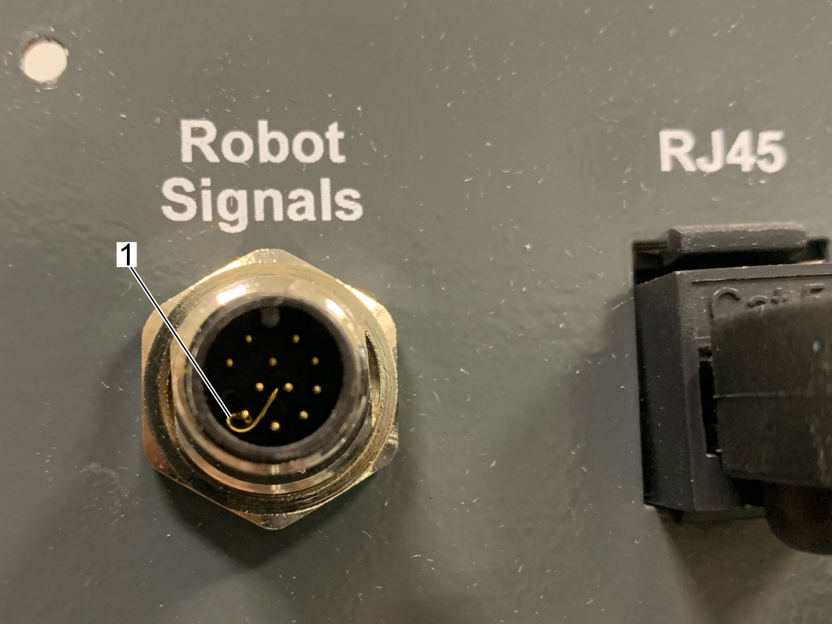

Robot Serial Number Tag Locations
[1] HRP-1
[2] HRP-1
[3] HRP-2
[4] HRP-3

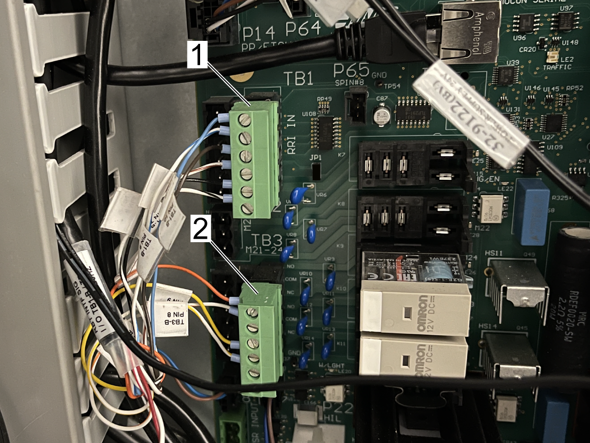

The TB1-B and TB3-B Connectors are plugged into the wrong location or unplugged. Plug the connectors into the correct location. See the SRVO-004 Fence Open section below.

9156.406 SRVO-406 DCS SSO SVOFF input 1,1 The K9 and K10 Relays on I/O PCB are not installed. Make sure you have the K9 and K10 relays installed on the I/O PCB.  Refer to the Robot Installation Procedure, Electrical section.
The fence is open in Run Mode. Make sure the interlock is working and that machine is receiving the interlock input signal.
The TB3-B wiring is damaged or miswired. Check the wiring for the TB3-B connector. Compare the wiring of the connector to the wiring diagram.
The DCS Cartesian Position Check Zone was not setup. Follow the DCS Cartesian Position Check Zone procedure.
The Safe I/O for Input 1 is set incorrectly. Follow the Safe I/O Input 1 procedure below.

SRVO-230/231 Chain1/2 abnormal & SRVO-266/267 FENCE1/2 status abnormal
This circuit connects with the Fanuc Control—starting at the Safety Relay in the Electrical Interface box and ending at TBOP20 in the Fanuc Control box. Inspect the cables for damage.
Example: The pins on the Robot Signal cable M12 connector were bent out of place [1].
Inspect the TBOP20 connector and pins. Inspect the M12 connector that plugs into the Electrical Interface box.

SRVO-004 Fence Open
Plug the connectors into the correct location according the Electrical Diagram.
TB1-B[1] is the connector on the right.
TB3-B[2] is the connector on the right.
