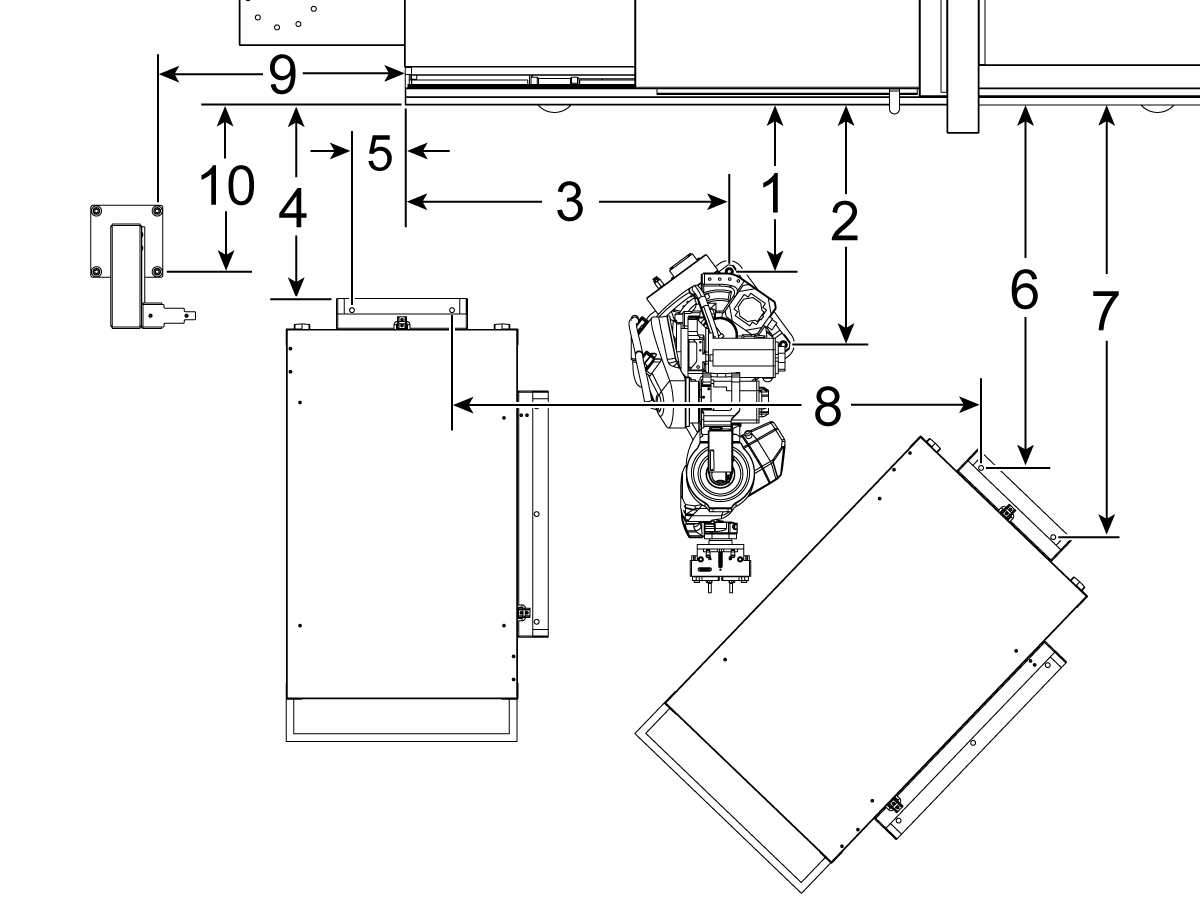

Robot Placement
Table 1[1]
Table 2[2] (optional)
Place the Fanuc Control Box on the right side of the machine next to the control panel[3].
Part Flip Station [4].

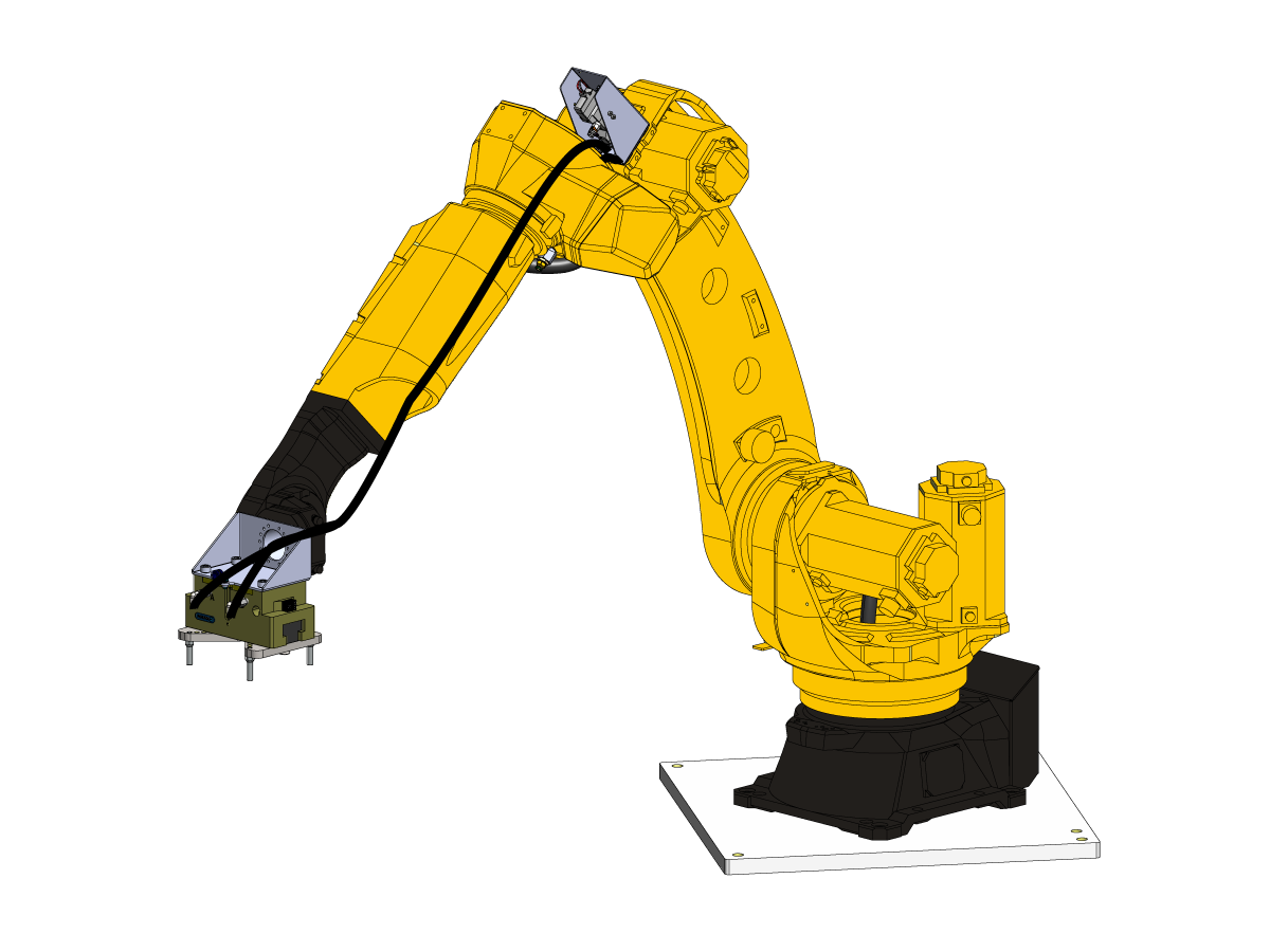

Robots With Weldment Base
Robots with a Weldment Base
Measure these dimensions from the machine skirt to the robot mounting holes on the robot stand.
 Note: The following dimensions are recommended distances. The position may vary depending on the users application.
Dimension Number VF-1/2 VF-3/4 VF-5
1 (Rear right mounting hole of the robot to the front of the machine) 27.5 in. (698.5 mm) 23.0 in. (584.2 mm) 20.0 in. (508 mm)
2 (Front right mounting hole of the robot to the front of the machine) 37.0 in.  (939.8 mm) 32.5 in. (825.5 mm) 30.0 in. (762 mm)
3 (Rear right mounting hole of the robot to the left side of the machine) 25.0 in. (635 mm) 42.0 in. (1066.8 mm) 49.5 in. (1257.3 mm)
4 (Front table bracket of Table 1 to the front of the machine) 26.5 in. (673.1 mm) 22.5 in. (571.5 mm) 19.0 in. (482.6 mm)
5 (Left mounting hole of the front table bracket of Table 1 to the left side of the machine) 20.0 in. (508 mm) 1.0 in. (25.4 mm) 14.0 in. (355.6 mm)
6 (Left mounting hole of the front table bracket of Table 2 to the front of the machine) 53.0 in. (1346.2 mm) 48.5 in. (1231.9 mm) 45.0 in. (1143 mm)
7 (Right mounting hole of the front table bracket of Table 2 to the front of the machine) 62.0 in. (1574.8 mm) 57.5 in. (1460.5 mm) 54.5 in. (1384.3 mm)
8 (Left mounting hole of the front table bracket of Table 2 to the right mounting hole of the front table bracket of Table 1) 59.0 in. (1498.6 mm) 59.0 in. (1498.6 mm) 59.0 in. (1498.6 mm)
9 (Rear right anchoring hole of Part Flip Station to the left side of the machine) 31.5 in. (800.1 mm) 14.5 in. (368.3 mm) 1.0 in. (25.4 mm)
10 (Front right anchoring hole of Part Flip Station to the front of the machine) 18.0 in. (457.2 mm) 13.5 in. (342.9 mm) 8.5 in. (215.9 mm)

HRP-25kg VMC Fence Layout
Attention: The fence anchors will use a 3/8th drill bit, they are NOT the same size as the robot anchors.

Gripper Installation
Install the gripper to the robot end effector mounting face.
Install the shaft gripper assembly to the robot end effector mounting face.
See the HRP-25kg Dual Gripper - Installation instructions for installing the dual gripper on the HRP-25kg.

Fixing / Anchoring Requirements
The Haas Robot Package-25kg needs to be anchored to be sufficiently stable when used according to Haas defined part size and weight limits. See the Robot Anchoring section below.

Robot Lifting
Robot Lifting Requirements
Use this information for lifting/moving Robot Package-25kg.
The Haas Robot Package-25kg needs to be lifted according to Fanuc's recommendation. See the Fanuc Robot M-20iD/25 Mechanical Unit Operator's Manual, Chapter 1, Section 1 Transportation starting on page 1 for lifting/moving information.
HRP-25kg Fanuc Robot M-20iD/25 Mechanical Unit Operator's Manual
The Haas Robot Package-25kg, Part Table, and Part Flip Station needs to be anchored to be sufficiently stable when used according to Haas defined part size and weight limits. See the Anchoring Instructions (Drop-In Expansion) for anchoring information.
6
Route the air lines between the solenoid on robot arm and the gripper. Connecting the airlines to the corresponding color coded fittings. Install conduit to each pair of air lines.

Robot Lifting
Robot Installation
Table 1[1]
Place the Fanuc Control Box behind the machine next to the control panel[3].
Dimension Number ST-20/25 ST-20L/25L ST-30/35 & DS-30Y ST-30L/35L
1 (Rear right mounting hole of the robot to the front of the machine) 29.0 in. (736.6 mm) 29.5 in. (749.3 mm) 29.5 in. (749.3 mm) 29.0 in. (736.6 mm)
2 (Front right mounting hole of the robot to the front of the machine) 39.0 in. (990.6 mm) 39.0 in. (990.6 mm) 38.5 in. (977.9 mm) 38.5 in. (977.9 mm)
3 (Rear right mounting hole of the robot to the left side of the machine) 27.0 in. (685.8 mm) 42.5 in. (1079.5 mm) 27.0 in. (685.8 mm) 49.5 in. (1257.3 mm)
4 (Front table bracket of Table 1 to the front of the machine) 28.0 in. (711.2 mm) 28.5 in. (723.9 mm) 28.5 in. (723.9 mm) 28.5 in. (723.9 mm)
5 (Left mounting hole of the front table bracket of Table 1 to the left side of the machine) 21.5 in. (546.1 mm) 5.5 in. (139.7 mm) 21.0 in. (533.4 mm) 1.5 in. (38.1 mm)
6 (Left mounting hole of the front table bracket of Table 2 to the front of the machine) 54.5 in. (1384.3 mm) 55.5 in. (1409.7 mm) 54.5 in. (1384.3 mm) 54.5 in. (1384.3 mm)
7 (Right mounting hole of the front table bracket of Table 2 to the front of the machine) 63.5 in. (1612.9 mm) 65.0 in. (1651.0 mm) 63.5 in. (1612.9 mm) 63.5 in. (1612.9 mm)
8 (Left mounting hole of the front table bracket of Table 2 to the right mounting hole of the front table bracket of Table 1) 59.0 in. (1498.6 mm) 59.0 in. (1498.6 mm) 60.0 in. (1524.0 mm) 60.0 in. (1524.0 mm)
9 (Rear right anchoring hole of Part Flip Station to the left side of the machine) 24.5 in. (622.3 mm) 9.0 in. (228.6 mm) 24.5 in. (622.3 mm) 2.0 in. (50.8 mm)
10 (Front right anchoring hole of Part Flip Station to the front of the machine) 17.5 in. (444.5 mm) 18.0 in. (457.2 mm) 18.0 in. (457.2 mm) 17.5 in. (444.5 mm)
Robots with a Cast Base
Measure these dimensions from the machine skirt to the anchor holes on the robot base.
1 (Rear right mounting hole of the robot to the front of the machine) 26.0 in. (660.4 mm) 26.5 in. (673.1 mm) 26.5 in. (673.1 mm) 26.0 in. (660.4 mm)

Place the Fanuc Control Box on the back side of the machine next to the control panel[3].
The plate the robot is mounted on should be orientated with the extra hole [4] pointed toward the machine.
The anchoring plate made before 1/3/2024 [1] will have only four anchoring holes [3] in the corners.
The anchoring plate made after 1/3/2024 [2] will have the original four anchoring holes [3], but also has an additional eight (8) anchoring holes [5].
The mounting plate requires at least four (4) anchors to be used and if only four are used the original holes in each corner [3] must be used. If eight (8) anchors are to be used, use the new outer holes [5].
Measure these dimensions from the machine skirt to the edge of the robot base plate.
Dimension Number UMC-500 UMC-750 UMC-1000
1 (Front side of robot base plate to the side of the machine) 17.0 in. (431.8 mm) 17.0 in. (431.8 mm) 17.0 in. (431.8 mm)
2 (Left side of robot base plate to the front of the machine) 9.5 in. (241.3 mm) 14.5 in. (368.3 mm) 16.5 in. (419.1 mm)
3 (Front table bracket of Table 1 to the side of the machine) 13.0 in. (330.2 mm) 17.0 in. (431.8 mm) 15.0 in. (381.0 mm)
4 (Left mounting hole of the front table bracket of Table 1 to the front of the machine) 22.0 in. (558.8 mm) 13.0 in. (330.2 mm) 15.0 in. (381.0 mm)
5 (Left mounting hole of the front table bracket of Table 2 to the front of the machine) 37.5 in. (952.5 mm) 37.5 in. (952.5 mm) 37.5 in. (952.5 mm)
6 (Right mounting hole of the front table bracket of Table 2 to the front of the machine) 46.5 in. (1181.1 mm) 46.5 in. (1181.1 mm) 46.5 in. (1181.1 mm)
7 (Left mounting hole of the front table bracket of Table 2 to the right mounting hole of the front table bracket of Table 1) 59.0 in. (1498.6 mm) 82.0 in. (2082.8 mm) 80.0 in. (2032 mm)
8 (Rear right anchoring hole of Part Flip Station to the left side of robot base plate) 28.0 in. (711.2 mm) 28.0 in. (711.2 mm) 28.0 in. (711.2 mm)
9 (Front right anchoring hole of Part Flip Station to the side of the machine) 22.0 in. (558.8 mm) 22.0 in. (558.8 mm) 22.0 in. (558.8 mm)
Robot Anchoring Requirements
The Haas Robot Package-25kg Base Plate, Part Table, Fence, and Part Flip Station needs to be anchored to be sufficiently stable when used according to Haas defined part size and weight limits. See the Anchoring Instructions (Drop-In Expansion) for anchoring information.

Gripper Assembly
In order for the dual grippers to reach the vise, the B axis may need to be tilted toward the robot.
This is the case for all UMCs with HRP-2.
Once a loading position is determined, the loading position can be saved by going to Current Commands -> Devices -> Automatic Part Loader -> Load part [2] -> Internal Axes Location for Load [1].  Press F2 to set the current position of the machine as the loading position.
More information about setting up HRP templates can be found at HRP - Operations.
If the load and unload locations need to be different, custom templates will need to be used. HRP - Operations - 9.3 - Custom template.
