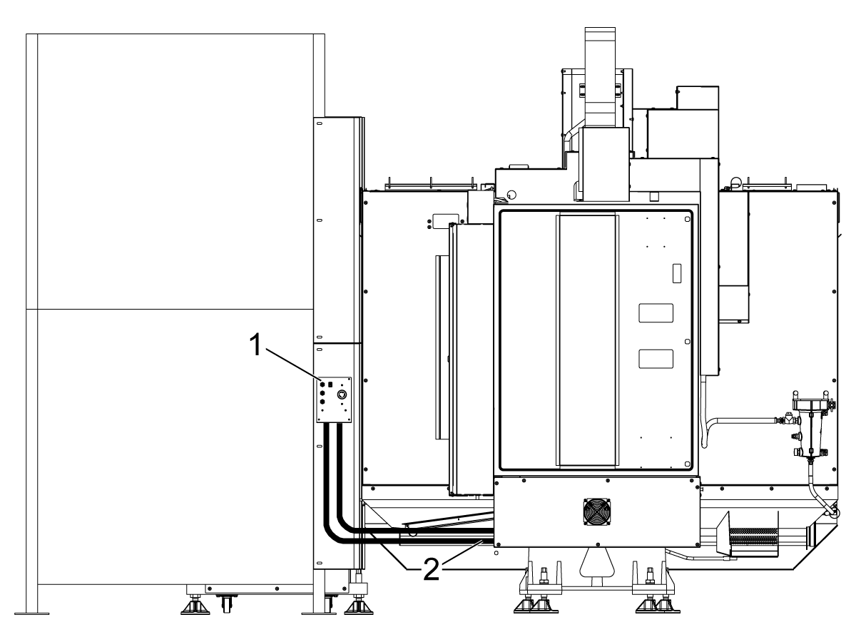

VMC Robot Interface Mounting Location
The Robot electrical interface box has magnetic mounts to attach to the machine sheet metal.
Mount the Robot electrical interface box [1] as shown in the picture.
Route the Robot interface electrical cables [2] along the enclosure with the magnetic mounts and zipties. Route the cable through the bottom of the electrical cabinet.

ST Robot Interface Mounting Location
Route the Robot interface electrical cables [2] through the bottom of the electrical cabinet.

Measure these dimensions from the machine skirt to the side panels of the table.
Note: The following dimensions are recommended distances. The position may vary depending on the users application.
The Haas Robot Package 1 is configured and sold by Haas with a pedestal/table that is sufficiently stable when used according to Haas defined part size and weight limits.
Place the robot table to the right of the machine. Use dimensions below to locate the table.
Install the leveling pads and raise the leveling screws until the wheels are off the floor.
Level the table using a bubble level.
Dimension Number DM/DT/UMC-350
1 (Table to the right side of the machine) 2.0 in. (50.8 mm)
2 (Table to the front side of the machine) 8.0 in. (203.2mm)
 Note: Move the applicable parts to the alternate side to match the configuration as necessary.

DM/DT/UMC-350 Robot Interface Mounting Location
The Robot electrical interface box has magnetic mounts to attach to the fence sheet metal.
Mount the Robot electrical interface box [1] next to the CALM cabinet as shown in the image.
 Note: Make sure the Interface box is mounted in a location so the height decal [2] can still be seen.
Route the Robot interface electrical cables [3] along the enclosure with the magnetic mounts and zipties. Route the cable through the bottom of the electrical cabinet.

UMC Robot Interface Mounting Location
