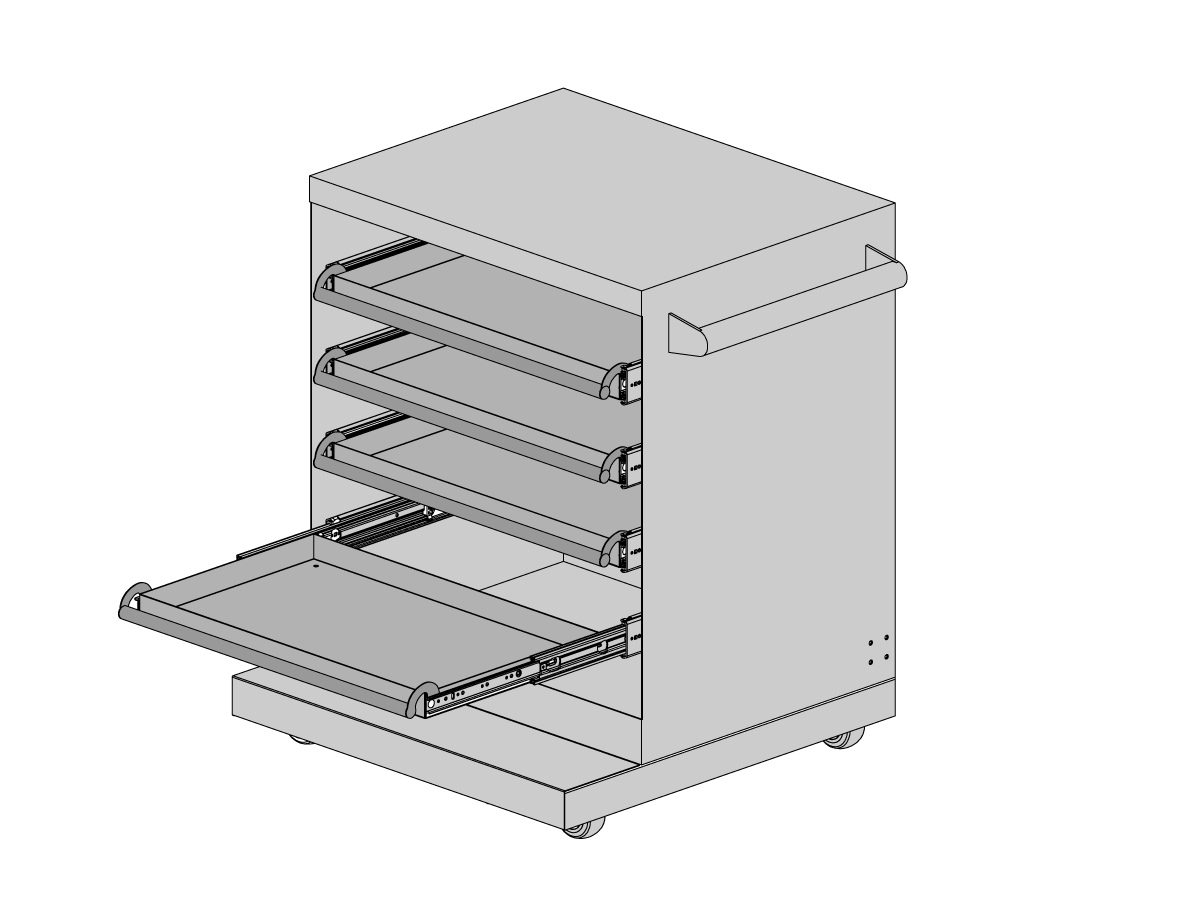

This procedure will show you how to install the Drawer Cart on a machine with a robot package.
Machine Compatibility:
  • VF-1/2, VM-2
  • ST-10/15
     IMPORTANT: ST-10/15 built with the medicine cabinet (approximately manufactured on October 2024 and higher), the glovebox will not be accessible with the above dimensions. Applies to Cobot and HRP.
  • ST-20/25
This procedure applies to the following kits:
  • 09-0307 - DRAWER CART KIT HRP-1
  • 09-0308 - DRAWER CART HANDLE PULL HRP-1
Note: If the robot is built before 1/1/2023. Order 25-15645A to mount the Drawer Pull for single gippers.

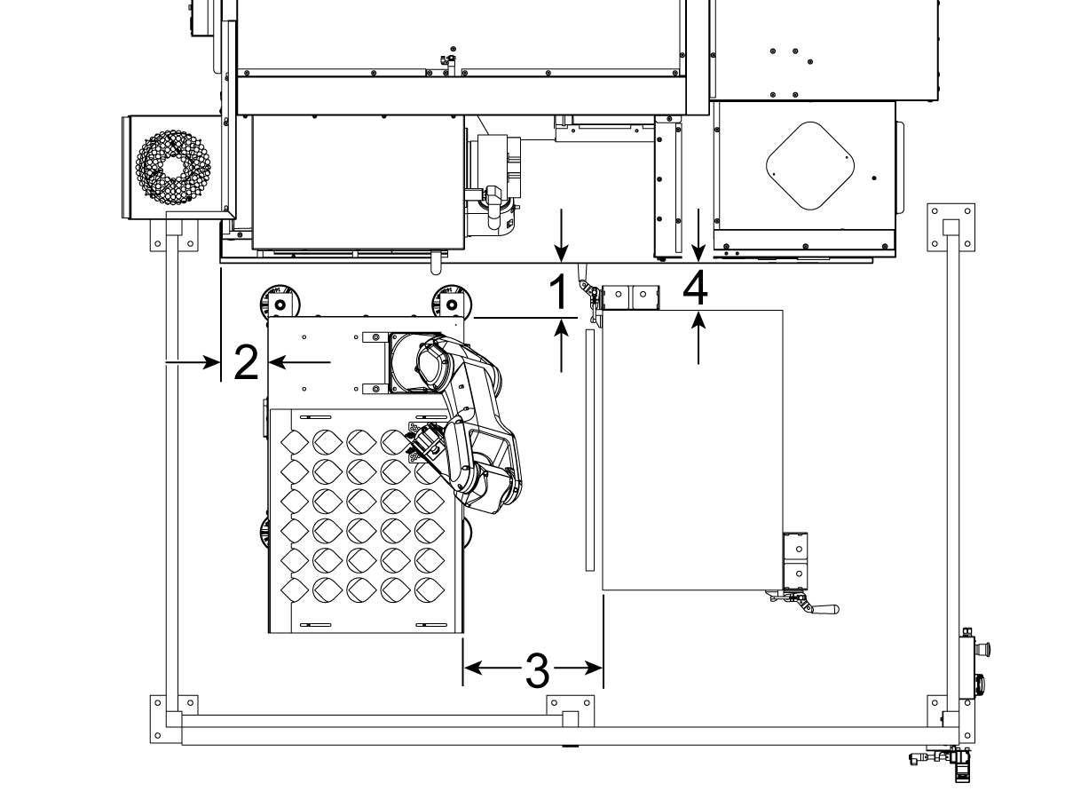

Haas Robot Package Drawer Cart Layout
Measure these dimensions from the machine skirt to the side panels of the robot table.
 Note: The following dimensions are recommended distances. The position may vary depending on the users application.
VF-1/2 & VM-2
Place the robot table againt the left front side of the machine. The table should be 1.5 inch (38.1 mm) [1] from the front of the machine. The table should be 13.5 inch (342.9 mm) [2] from the left side of the machine.
The Drawer Cart should be 33.0 inch (838.2 mm) [3] from the left side of the robot table. The Drawer Cart should be 1.5 inch (38.1) [4] from the front of the machine.
The Haas Robot Package 1 Drawer Cart needs to be anchored to be sufficiently stable when used according to Haas defined part size and weight limits. See the Anchoring Instructions (Drop-In Expansion) for anchoring information.
ST-10/15
The table should be 5.0 inch (127 mm) from the front of the machine [1]. The table should be 9.0 inch (228.6 mm) from the left side of the machine [2].
The Drawer Cart should be 33.0 inch (383.2 mm) [3] from the left side of the robot table. The Drawer Cart should be 8.5 inch (215.9 mm) [4] from the front of the machine.

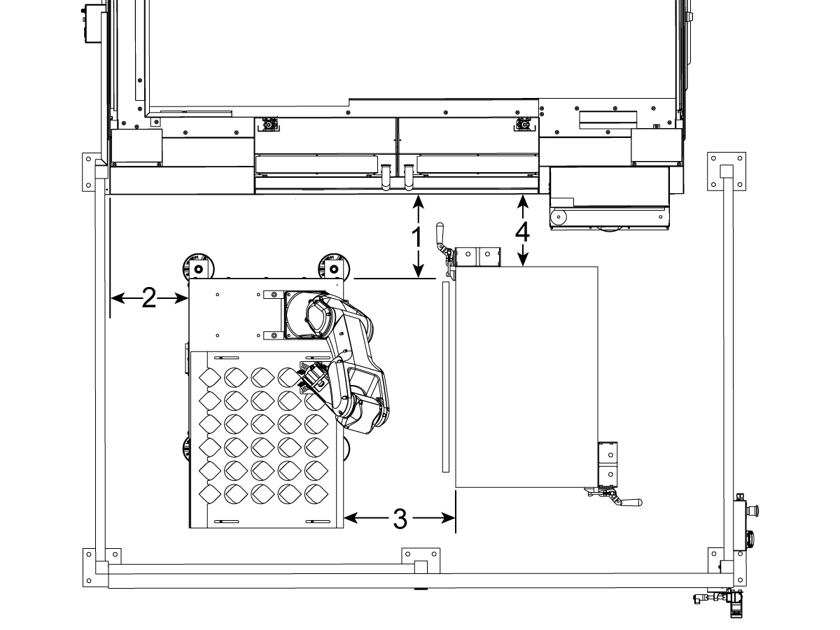

ST-20/25
The table should be 10.5 inch (266.7 mm) from the front of the machine [1]. The table should be 10.0 inch (254 mm) from the left side of the machine [2].
The Drawer Cart should be 33.0 inch (838.2 mm) [3] from the left side of the robot table. The Drawer Cart should be 10.5 inch (266.7 mm) [4] from the front of the machine.

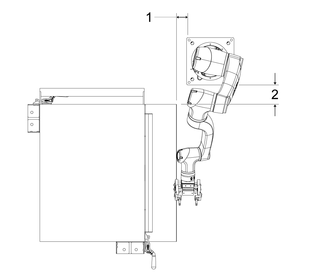

Haas Cobot Drawer Cart Layout
Measure these dimensions from the front side of the drawer cart to the side panels of the robot table.
The Drawer Cart should be 5.0 inch (127 mm) [1] from the front side of the robot table. The Drawer Cart should be 3.0 inch (76.2 mm) [2] from the left side of the robot table.
The Haas Cobot Drawer Cart needs to be anchored to be sufficiently stable when used according to Haas defined part size and weight limits. See the Anchoring Instructions (Drop-In Expansion) for anchoring information.

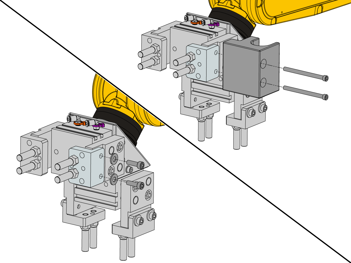

Gripper Drawer Pull - Installation
Install the Drawer Pull to Angle Bracket 25-15645A SINGLE GRIPPER ADPTR PLATE 90 DEG HRP-1.
Remove the hardware for the gripper finger adapter plate and install the Drawer Puller.
