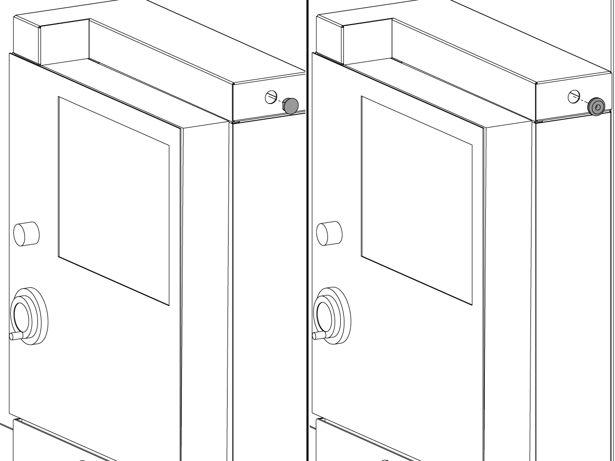

Complete the following on both sides of the door:
Remove the autodoor motor cover [1] and the autodoor motor assembly [2].
Install the new proximity switch bracket [3] to the existing proximity switch block [5].
Install the door always open proximity switch [4] to the bracket [3].
Install the drill guide [7] for the door open flag [6] and drill and tap 2x 10-32 holes through the sheet metal of the door.
  • Drill size: #21 or 5/32"
  • Tap 10-32 NF
Remove the template and install the door open flag with 2x flat head cap screws. Re-install the autodoor motor assembly, bracket, and cover.
Use provided shims to set the height between the proximity switch and the door open flag.

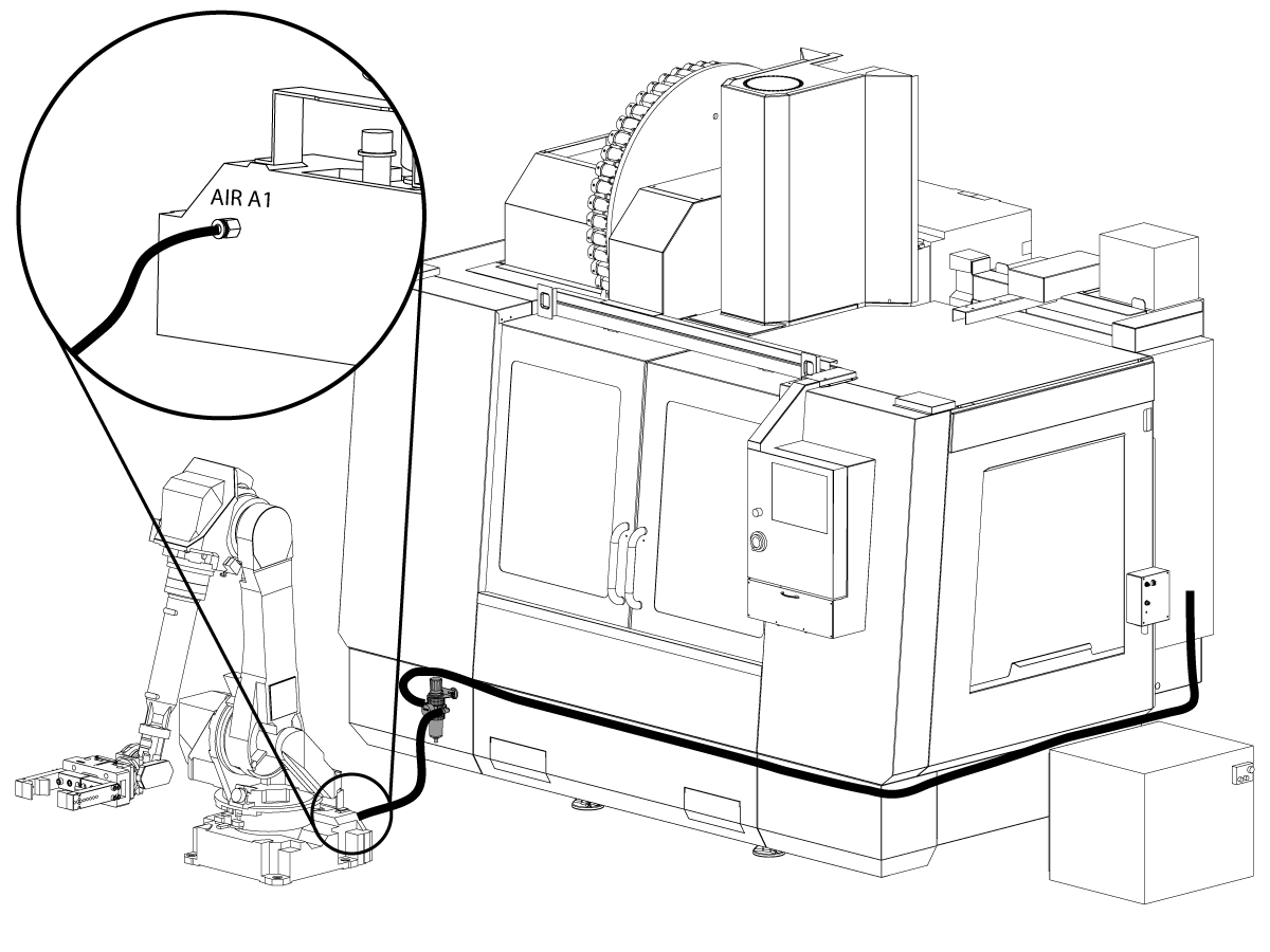

Turn the machine air supply OFF.
Inside the CALM cabinet, remove a NPT plug from one of the CALM manifold ports.
The Robot Gripper Air Regulator has magnetic mounts to attach to the machine sheet metal.
Mount the Robot Gripper Air Regulator to the front skirt of the machine near the robot.
Route the air line from the left side of the regulator along the front skirt of the machine to the CALM cabinet and install the push to connect fitting.
Route the air line from the right side of the regulator to the Air A1 port on the robot and install to the push-to-connect fitting.
Turn the machine air supply ON.
Set the regulator to air pressure required for your application. The higher the pressure, the greater the clamp force. Below is the air pressure range of the Single Gripper for the HRP-3.
  • Single Gripper Air Pressure Range - (36.0 - 100.0 psi)

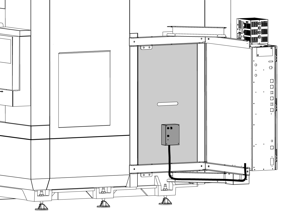

VMC Robot Interface Mounting Location
The Robot electrical interface box has magnetic mounts to attach to the machine sheet metal.
Mount the Robot electrical interface box [1] as shown in the picture.
Route the Robot interface electrical cables through the bottom of the electrical cabinet.

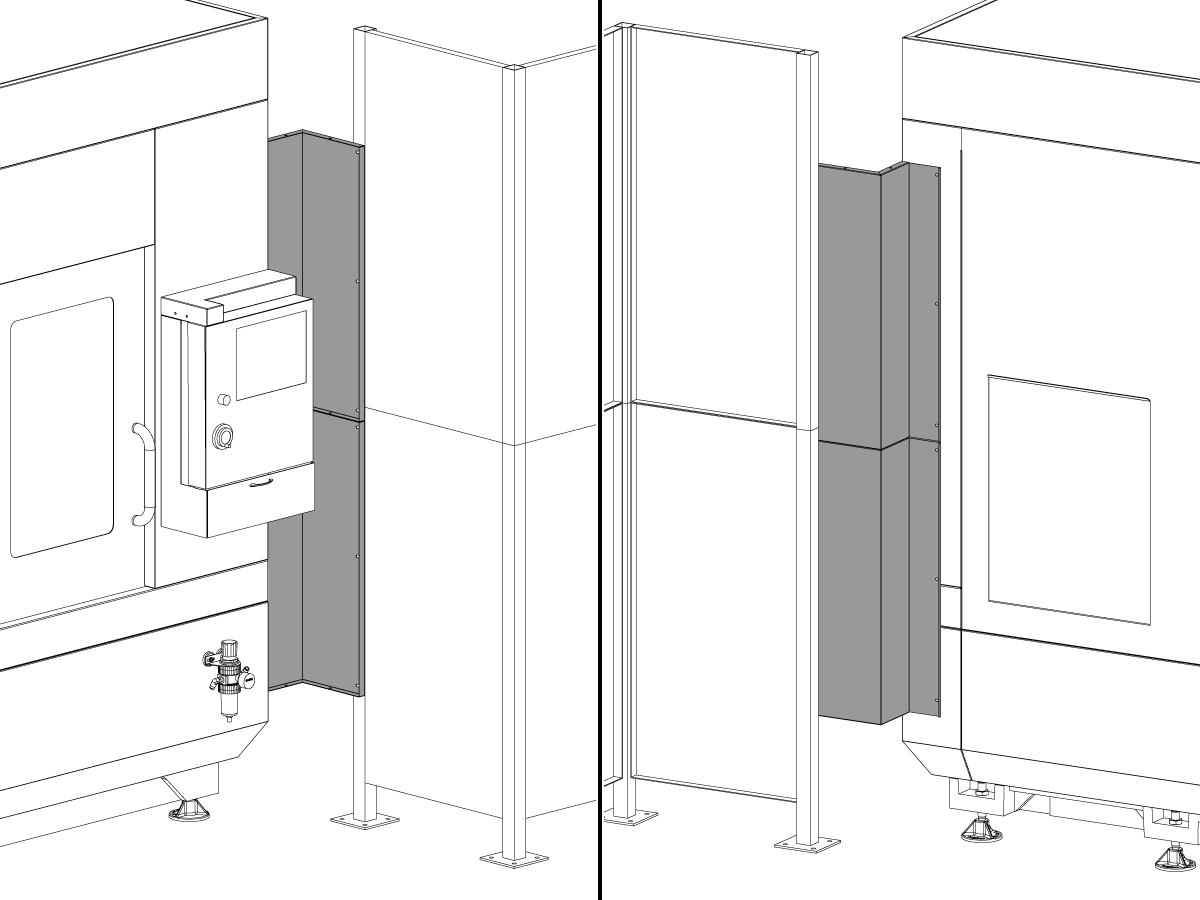

Robot Fence:
If the machine came equipped with the fence option, the robot fence and door interlock assembly need to be installed to machine. Follow the procedure below for installation:
Robot Fence Installation
HRP-50kg VMC Fence Layout - Version 1
HRP-50kg VMC Fence Layout - Version 2
Attention: The fence anchors will use a 3/8th drill bit, they are NOT the same size as the robot anchors.
Robot Fence:
Install the fence panel assembly to the fence post with the self tapping screws. The top of the fence panel assembly should be 22.5 inches from the top of the fence post.
Install the fence panel assembly to the front of the machine with the self tapping screws. The location installed will depend on the machine and fence location
Mount the Robot Gripper Air Regulator to the front skirt of the machine to the right of the HPU.
Route the air line from the left side of the regulator to the CALM cabinet and install the push to connect fitting.

ST Robot Interface Mounting Location
Route the Robot interface electrical cables [2] through the bottom of the electrical cabinet.

UMC Robot Interface Mounting Location
Mount the Robot electrical interface box [1] as shown.
Pendant Access Cover
Remove the plug installed on the Pendant Access Cover and install the rubber grommet.
If the Pendant Access Cover does not have the access hole, drill a 0.75" hole in the end of the cover.
UMC Robot Electrical & Air Routing
Route cable 33-1134 [1] from the RJH Holster along the fence to the Pendant Access Cover grommet to the SKBIF PCB.
Route cable 33-1135 [2] from the Interlock along the fence and machine skirt with the magnet mounts to the Electrical Interface Box.
Route cable 33-8561C [3] from the Electrical Interface Box along the 90 Degree Control Panel channel to Control Panel.
Route air hose [4] from the Air Regulator along the machine skirt to the Calm Cabinet.
Mount the Robot Gripper Air Regulator to the machine skirt below the pendant.
Route the air line from the right side of the regulator along the side skirt of the machine to the CALM cabinet and install the push to connect fitting.
Route the air line from the left side of the regulator to the Air 1 port on the robot and install to the push-to-connect fitting.

Cable P/N 33-8561C has multiple connections:
I/O PCB
  • Connect the E-STOP terminal block connections to SIO PCB TB-1B (see diagram)[1].
  • Verify the jumper is installed on the SIO PCB at JP1.
  • Connect the Setup mode terminal block connections to SIO PCB TB-3B (see diagram)[1].
  • Plug the User Relays into K9 and K10.  (see diagram)[11].
  • Connect the cable labeled P1 SIO to the SIO PCB at P1[2].
Note: Do not plug anything into the connector FILTER OV FAULT.

Robot Fence:
HRP-50kg UMC Fence Layout
Robot Fence:
Install the fence panel assembly to the fence post with the self tapping screws. The top of the fence panel assembly should be 14.5 inches from the top of the fence post.
Install the fence panel assembly to the side of the machine with the self tapping screws. The location installed will depend on the machine and fence location
Robot Fence:
Install the control panel fence panels together. Install the fence panel assembly to the 90 degree control panel channel.
Install the fence panel assembly to the fence post and side of the machine with the self tapping screws. The location installed will depend on the machine and fence location

Route the air lines between the solenoid on robot arm and the gripper. Connecting the airlines to the corresponding color coded fittings.
Install conduit to each pair of air lines. Use the cable clamps to secure the conduit and airlines on the robot arm.
 Note: Turn on the machine air by turning the valve in the CALM cabinet.
