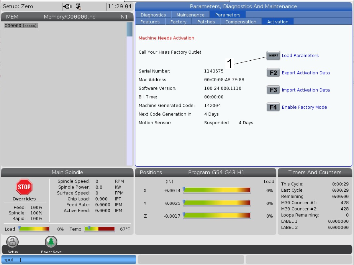

The machine configuration updates are needed when an option has been added or hardware on the machine has been replaced.
Contact your local Haas Factory Outlet if you need configuration files loaded into your machine.
For Service Techs: Log-in to HBC. Navigate to Service > Utilities > Documents and Software >  12 - Activation Codes and Configuation Files. Open document 3A or 3B, depending on your software version.
Note: Only Haas Certified Service Technicians can log into this site.
