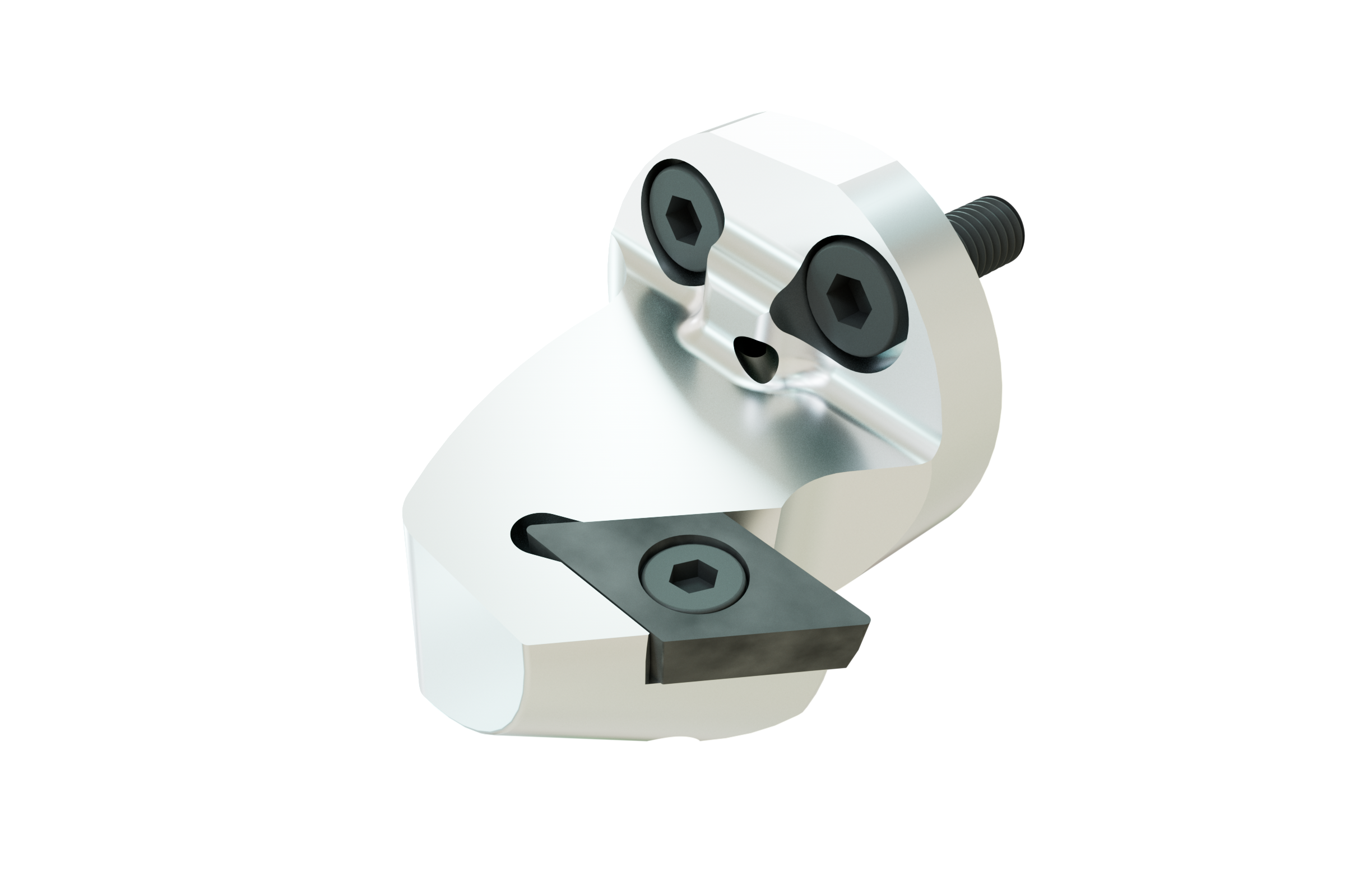

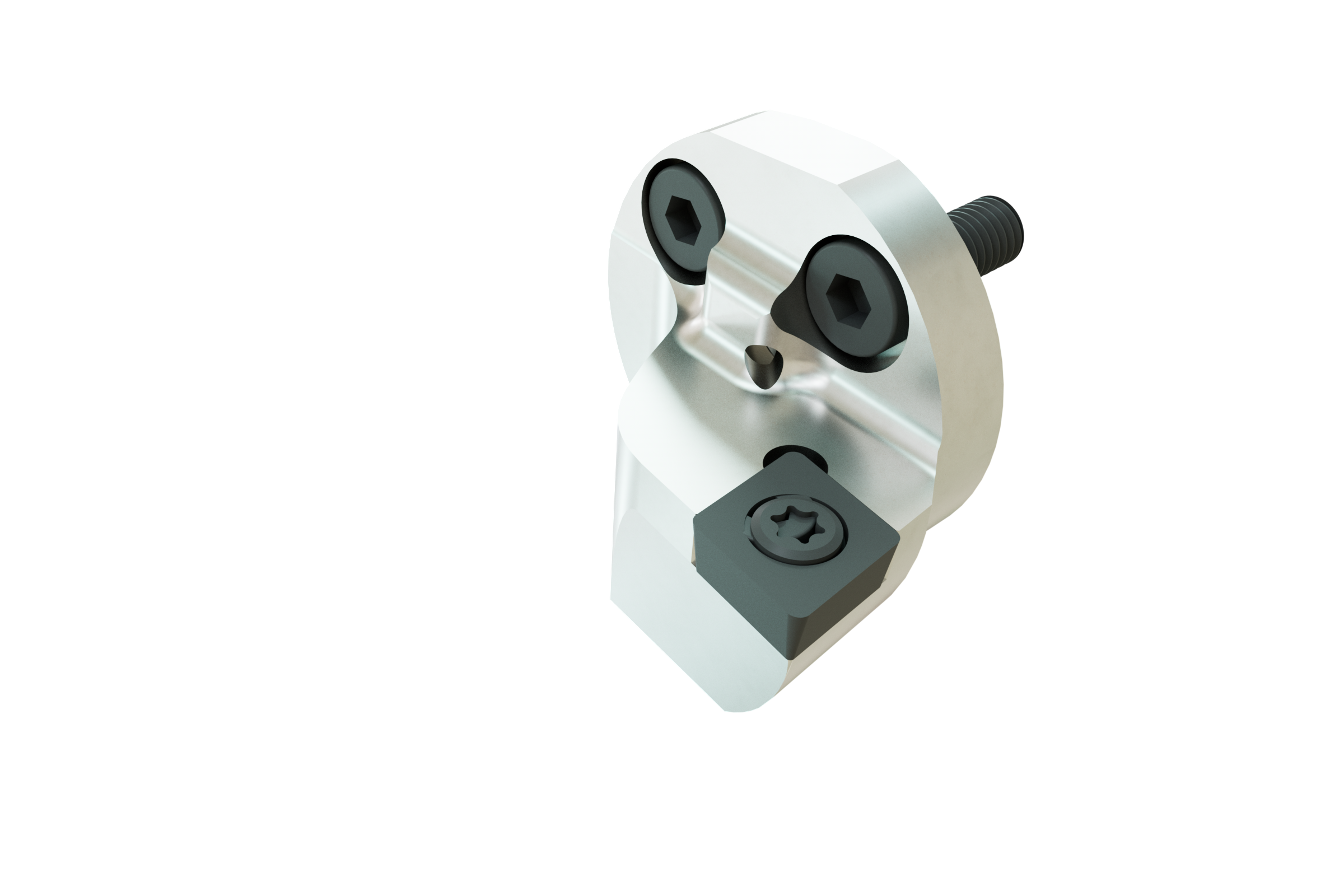

Modular Boring Bars are a popular alternative to conventional solid one-piece indexable boring bars. Consisting of a two-piece assembly – a bolt-on head and a boring bar body – modular boring bars offer greater flexibility in setup and can deliver better performance compared to traditional boring bars. With the ability to swap out any compatible bolt-on serrated head, tasks such as profiling and linear boring can all be performed without the need to switch to an entirely different tool.
Modular Boring Bars, available in various styles and sizes, are designed with a through-tool coolant and a serrated bolt-on locking interface to ensure the most optimal tool securement and performance. Offering overhangs ranging from 5xD to 10xD, with the option for anti-vibration damping features. Anti-vibration damped boring bars are equipped with an internal pre-tuned damping system engineered to deliver superior performance and reduce chatter during operations.
Modular Bolt-on Boring Heads, available in a wide range of styles and sizes, are designed with a serrated bolt-on locking interface to ensure a secure and reliable connection. These heads are cost-effective and offer excellent flexibility for high-volume production. Simply swap the bolt-on boring head, there’s no need to replace the entire boring bar. Integrated through-tool coolant ensures optimal lubrication and chip evacuation, enhancing tool life and overall performance.

How to choose Modular Bolt-On Head
  1. Determine your Minimum Machining Diameter [øD].
    To have the best performance out of your boring bar; Determine your minimum machining diameter to have the best Diameter-to-Stick out ratio. Utilizing the largest shank diameter possible based on workpiece is recommended; chip evacuation space is needed to avoid chip packing.
  2. Determine Insert Style.
    Insert styles range from 80˚ Rhombic, 55 ˚ Rhombic, 35 ˚ Rhombic, and T style Inserts; Inserts can also be determined by Inscribed Circle Diameter [IC] and Cutting-Edge Length [L10]. Different types of jobs require different types of inserts, from roughing, finishing, and profiling. Select which is best for your application.
  3. Determine desired clamping Style.
    Clamping styles are commonly associated with different types of tool holding. See chart for best comparison.
  4. Determine Hub Diameter [øC].
    Determining Hub Diameter can be done before or after selecting your preferred Bolt-on Head. Refer to parametric drawing to determine what diameter hub is needed for your application.

CLAMPING STYLES
Clamping Styles
____________________________
M – Multi-Lock System*
• For negative-style inserts
P – Lever-Lock System
S – Screw-On System
• For positive-style inserts
D – Double-Clamp System
• Powerful single-lever screw clamping
• Spring design releases clamp automatically
• Optimized for chip flow
• Eccentric lock pin secures the insert against the side
• Top clamp provides rigid downward clamping
S – Screw-On System
* For multi-lock holders: Rotate the eccentric lock pin counterclockwise until the insert drops on, and then rotate the eccentric pin clockwise to secure the insert against the side of the holder. Install the top clamp to hold down the insert.
