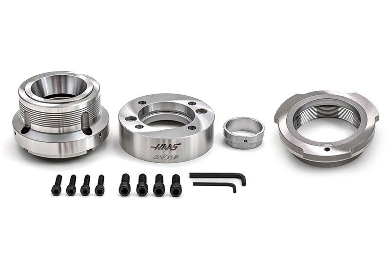

HQCBD-52, Dead Length Collet Chuck for A2-5 Spindle Nose, M55x2 Drawbar Nut
Part #: 05-0331
CBD-H52A5, M55x2 AG
Price: 2599.95 ( / unit)
Price: 62498.95 ( / unit)
Price: 18599.95 ( / unit)
Price: 2499.95 ( / unit)
Price: 11249.95 ( / unit)
Price: 26249.95 ( / unit)
Reduce your lathe set-up times with this Haas quick-change collet chuck. Collets are changed in seconds, using a handheld collet changing tool (not included), making the changeover from one size material to another fast and easy. This dead-length style A2-5 collet chuck is compatible with Haas ST-10 lathes with 1.75" (44.45 mm) bar capacity. Accepts a wide range of quick-change collets, in smooth and serrated styles (not included).
Haas Collet Chuck 52
____________________________
  • Dead length collet chuck
  • Compatible with Haas ST-10 lathes with 1.75" (44.45mm) bar capacity, including long-bed versions and Y-axis
  • Collet changes in seconds (requires handheld collet changing tool)
  • High clamping accuracy and rigidity
  • Sealed design for long life and minimal maintenance
  • Uses rubber grip collets for better grip and larger gripping range
*VERIFY YOUR DRAWTUBE THREAD SIZE*
This collet chuck will only fit on Haas ST-10 lathes that feature an M55 thread. Please refer to the layout drawing of your machine to verify the drawtube thread and ensure an accurate fit.
NOTE: Spindle reduction sleeve/liner length may need to be modified.
Part Transfer Minimum Distance
NOTE: Ensure that your part transfer distance is suitable for your application. The part transfer minimum distance will vary depending on your machine and collet chucks.
For dual-spindle applications, we recommend referring to your machine's dedicated machine layout drawing (MLD) to determine the face-to-face distance between spindles.
For legacy machines, this distance may be manually measured.
After subtracting the overall length of your chucks from the spindle face-to-face distance, determine if the resulting part transfer minimum distance is too large for your intended workpiece. Alternative solutions may be required for proper part transfers.
Technical Documents
  • Chuck and Spindle Nose Comparison Chart
  • Setup Manual
Type Collet Chuck
Collet Type Dead Length Collet Chuck
Machine Models ST-10L, ST-10, ST-10Y
Collet Series HRG-52R, HRG-52RT
Spindle Nose A2-5
[ØD] Bore Diameter 2.09 in \ 53.0 mm
[ØBD] Body Diameter 5.51 in \ 140.0 mm
[ØA] Flange Diameter 5.51 in \ 140.0 mm
[ØB] Nose Diameter 4.57 in \ 116.0 mm
[ØF] Spindle Nose Diameter 3.25 in \ 82.56 mm
[C] Flange Length 2.64 in \ 67.0 mm
[E] Nose Length 39.8 in \ 1.57 mm
[OAL] Overall Length 4.29 in \ 109.0 mm
[G] Throat Depth 2.05 in \ 52.0 mm
Draw Nut Thread Size M55x2.0
Concentricity 0.0004 in \ 0.01 mm
Maximum Collet Capacity 2.05 in \ 52.0 mm
Minimum Collet Capacity 0.157 in \ 4.0 mm
Maximum RPM 7000
Maximum Clamping Force 20704.1 lbs \ 92.1 kN
Weight 19.6 lbs \ 8.9 kg
Country of Origin Taiwan
